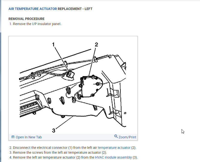

I attached the manual process for your review or others if they visit the site.
Also, here is a guide that will help as well:
Let us know if you have other questions. Thanks

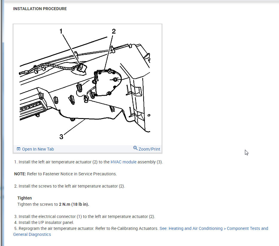

I just got a new A/C door actuator but when I hooked it up, it does'nt seem to work and I still get hot air out the middle dash vent and cold air out the passenger vent when the A/C is turned on.

because the actuator has to be re calibrated.try this first,Clear all DTCs.
Place the ignition switch to the OFF position.
Install the HVAC actuator.
Connect all previously disconnected components.
Remove the HVAC/ECAS fuse for a minimum of 10 seconds .
Install the HVAC/ECAS fuse.
Start the vehicle.
Wait 40 seconds for the HVAC control module to self-calibrate.
Verify that no DTCs have set as current DTCs.
This guide should help us fix the problem as well.

It sounds like you have a blend door actuator that has gone out. Here is a guide that has a video that will help you fix the problem.

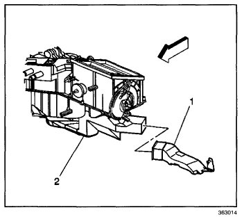

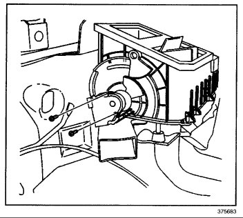

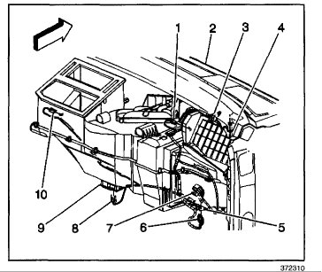

Here are the directions for removal and replacement of the component direct from Alldata. Let me know if it helps.

Remove the floor air outlet duct extension (1) from the floor duct (2).
Remove the center console.
Remove the screws from the center console duct.
Remove the center console duct.
Disconnect the electrical connection from the mode actuator (10).
Remove the mode actuator mounting screws from the HVAC module.
Remove the mode actuator as an assembly with the actuator cam.

Install the mode actuator as an assembly with the actuator cam.
Line up the heater/defroster valve lever with the mode actuator cam slot.
Line up the A/C valve lever with the mode actuator cam.
NOTE: Refer to Fastener Notice in Service Precautions.
Install the mode actuator mounting screw to the HVAC module.
Tighten
Tighten the screw to 1.6 N.m (14 lb in) .
Connect the electrical connection at the mode actuator (10).
Install the center console duct.
Install the screws from the center console duct.
Tighten
Tighten the screw to 1.6 Nm (14 lb in) .
Install the center console.
Install the floor air outlet dud extension (1) to the floor air duct (2).
