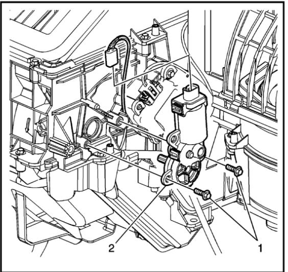

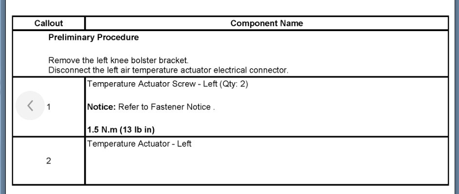

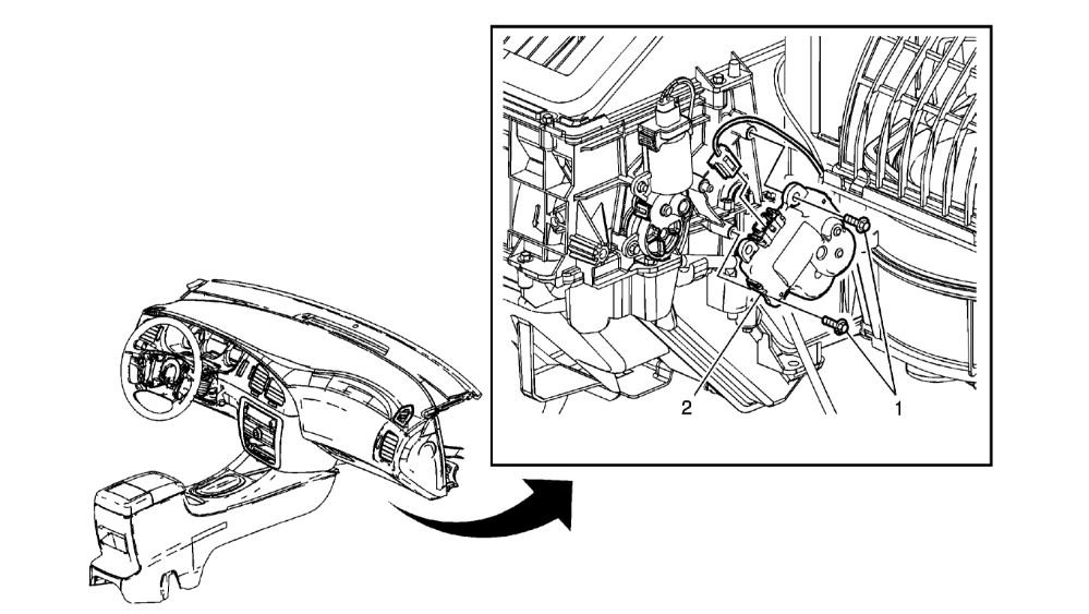

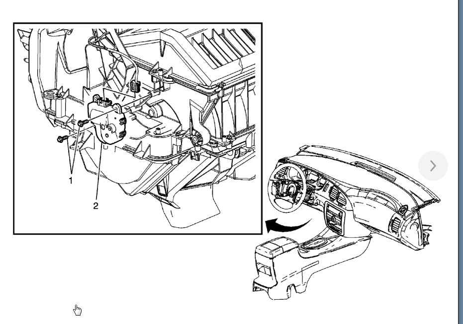

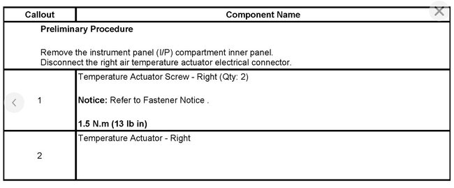

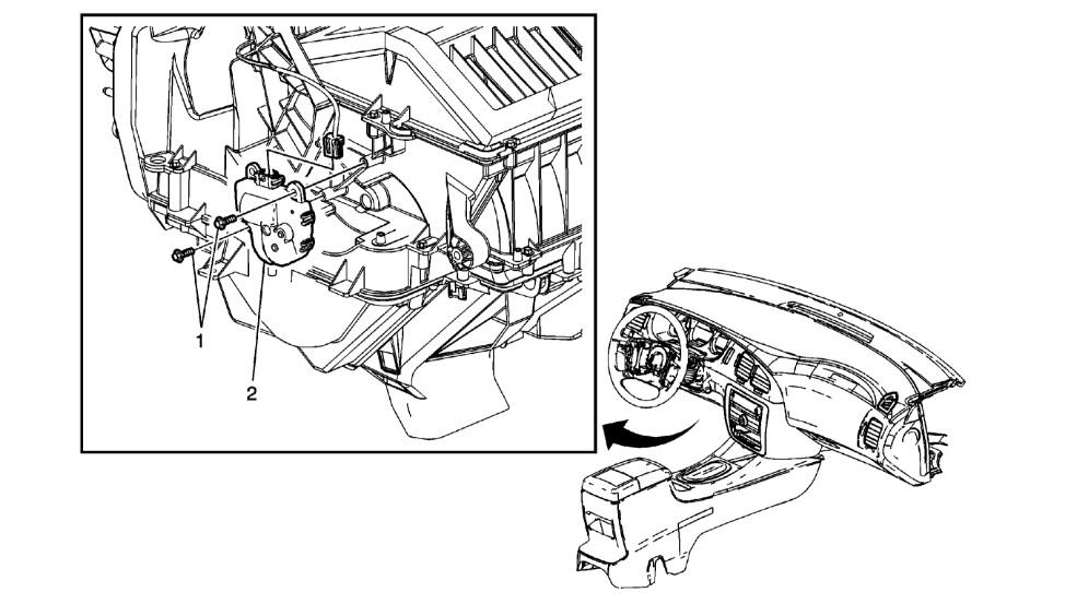

BW9051
Is changing drivers side blend door actuator under dash of a 2005 Impala done same way as in 2006 Impala?
Dec 23, 2020 at 2:39 AM (Merged)
Good evening.
Yes, they are the same procedure for the blend door. Check out the diagrams (Below). Please let us know if you need anything else to get the problem fixed.
