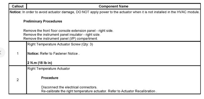

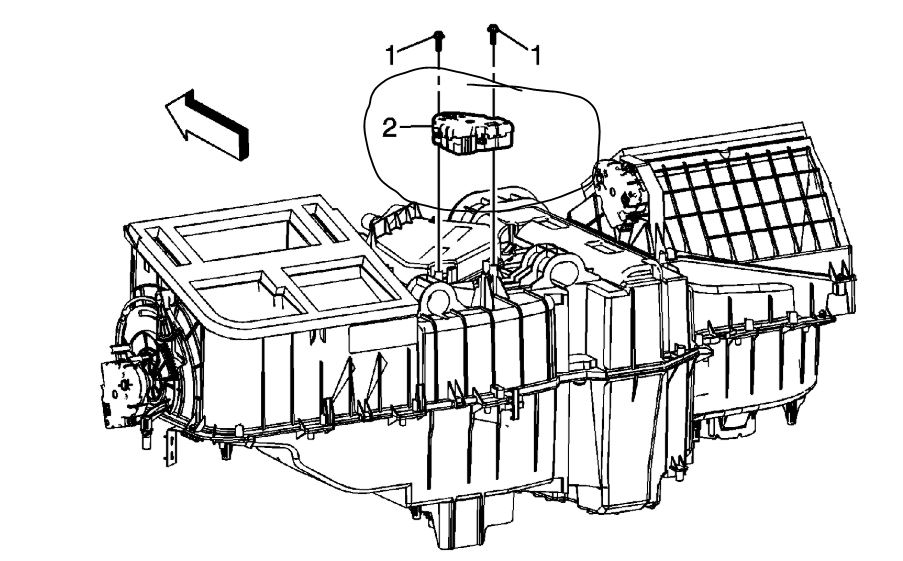

Good morning,
I attached the location of the passenger side mode door actuator. It attaches to the blend door in the case itself.
