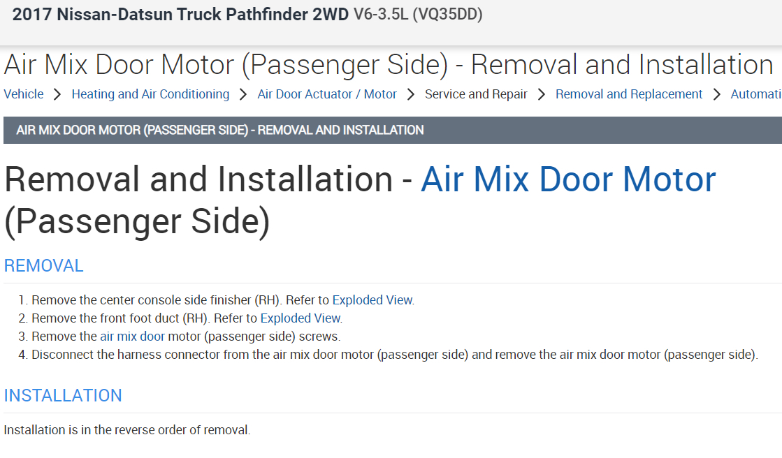

I need to replace the blend door actuator on the passenger side on my vehicle listed above, but i do not know the right location. How do i replace it? Thank you
Oct 1, 2024 at 8:15 AM
  • 55,433 POSTS

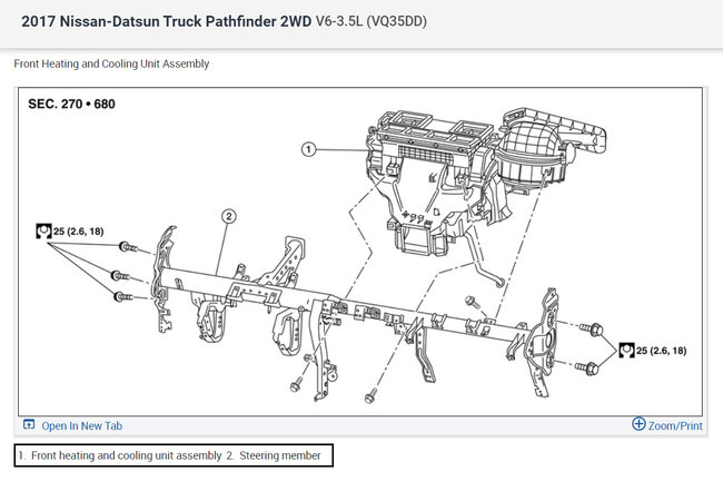

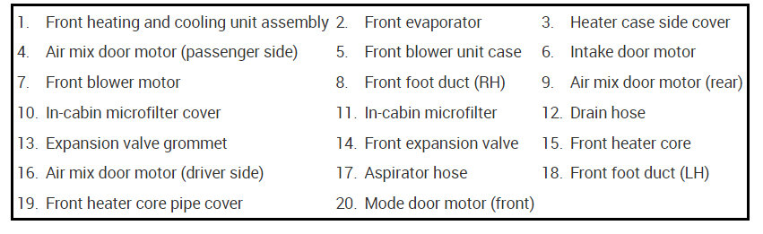

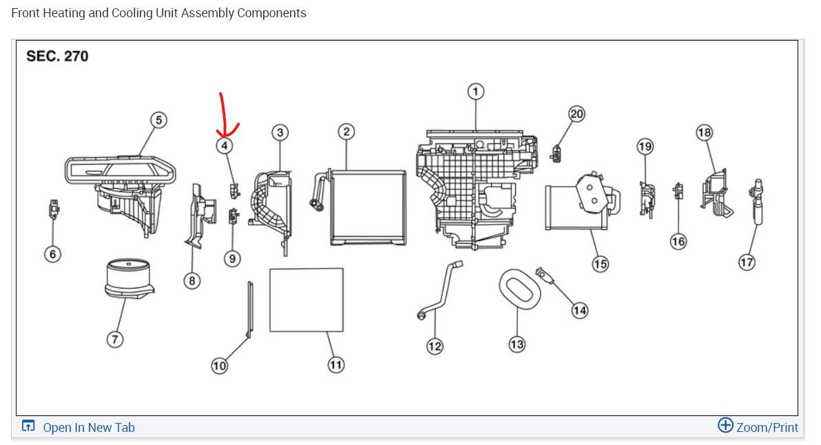

Sure, here is the front temperature air mix blend door actuator for the right side of the HVAC system. Check out the images (below). Let us know if you need anything else.
