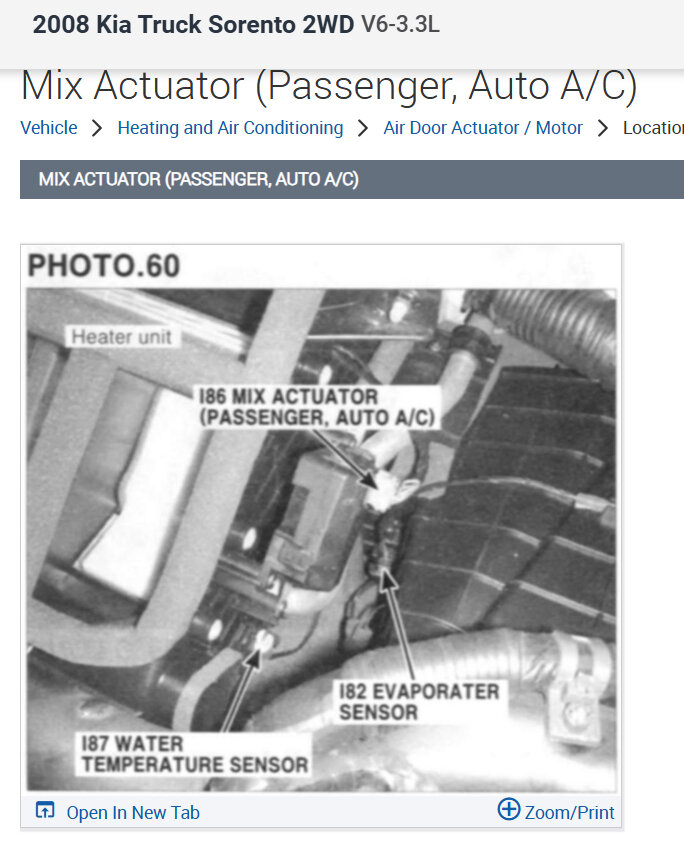

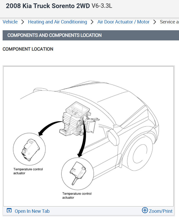

Yep, here are the locations of the blend door actuators, I will also send you an email. For the passengers side blend door actuator you will need to remove the glove box and the lower panel on the passengers side. Check out the images (below). Let us know if you need anything else.

Hey, thanks a whole lot, Ken! Do you have any idea what the part number would be for the passenger side actuator would be?

If you don't have heat on the drivers side it wouldn't be the passenger side actuator. However the Kia part number is 971542G000 That covers both sides as well as the mode actuator, the only one different is the recirculate door.
