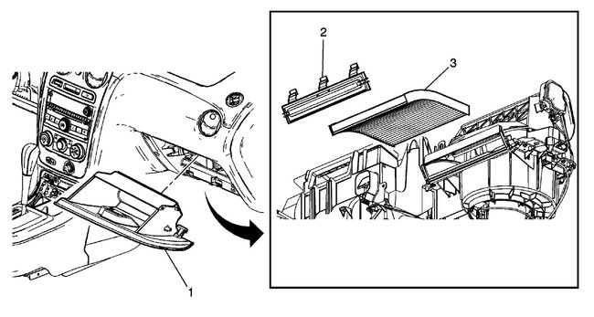

Can you tell me if this actuator fits on my car and if it goes under my glove compartment . I tried to locate the actuator in the glove compartment and was unable to find it
Sep 4, 2025 at 9:59 AM
MECHTRIX
  • 599 POSTS

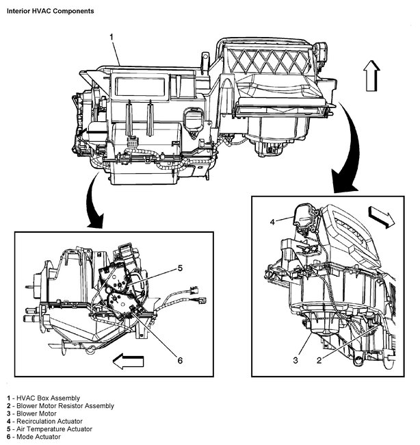

Here a diagram of the actuators please click below can you post a photo thanks good luck

What is the issue you have? The blend door actuator is 5 in the image, it controls temperature, it is the top actuator above the drivers footwell. Number 6 (below 5) on the image is the mode actuator it controls where the air comes out, floor, dash or defrost. The one on the top right is the recirculate actuator, it controls where the air comes from, inside or outside the vehicle.

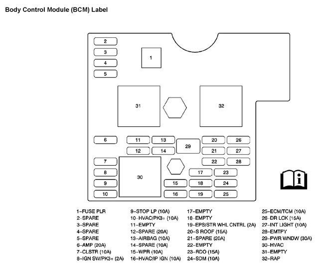

In this image theres a fuze number 10 and a relay number 30 for hvac good luck

Id say before you jump into it id check all fuzes relays control panel because you rarely see both sides go out at the same time i think the actuators should be fine it may just be a comuncation thing or a grounding issue I believe your problem might be elsewhere ...and like Steve was asking can you provide some detail as to the chain of events I believe we can help and maybe in the procces save you a little time and money but we need your help also some photos would be great .. let is know thanks

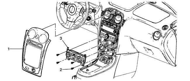

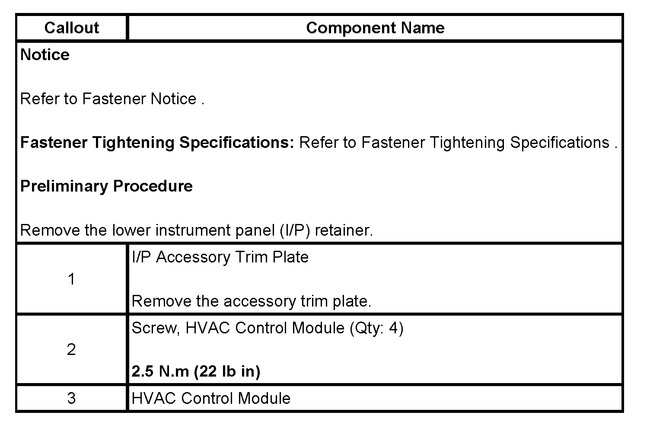

Just wondering how long this has been broken was there any signes before hand ? Heres a diagram of the hvac control modual and accompanying parts list id check all the plugs behind it just to make sure ..also the modual itself ..it may be struggling

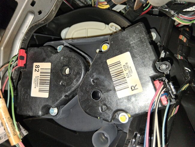

DEMKIDSMAMAA
  • 8 POSTS
That's under my driver side . Since the air is blowing low pressure on that particular side is that the side we should be focused on replacing ?

It only let me upload that 1 picture . I have 2 video clips (my car startup & my a/c being turned on) I want to show someone .

Before replacing anything watch those actuators as you move the controls, one will be the temperature control the other is the mode control. If they move OK then go to the blower motor and check that the cabin filter isn't plugged with dirt or debris. Then use a mirror to look into the blower motor to see if anything is there. Wouldn't want to replace a bunch of parts only to discover that a mouse had built a nest in the blower (that would cause a rumble and low air flow)

The recirculate actuator is the only one back there and it is on the end of the HVAC case. It only moves the recirculate door.
