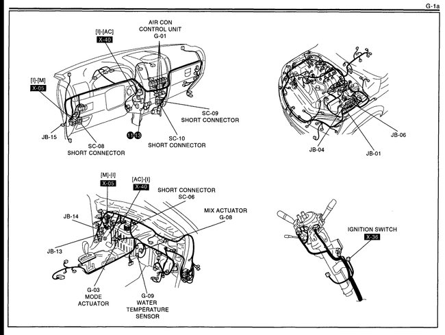

Located one of the two blend door actuator under dash but cannot find the other actuator to check it. The car does not run hot, but the heater only blows cold air.
Nov 24, 2017 at 3:11 PM
STEVE W.
  • 15,418 POSTS
It is buried in the dash on the side of the HVAC box. Kia does not have the service information on it in their books though. There is a YouTube video on an 2007 that uses the same heater assembly.
Search "2007 Kia Sedona heat door actuator replacement".
Nov 24, 2017 at 3:50 PM
KHLOW2008
  • 41,812 POSTS
Blend door actuators are on either side of dash, have you checked both sides?
Depending on venting system, some are only equipped with one blend door actuator if system does not have individual driver and passenger controls.
