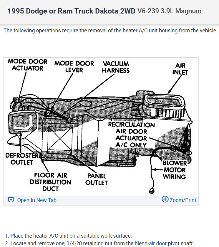

Blend door actuator location and replacement guide needed?
1995 DODGE DAKOTA
150,000 MILES • 3.9L • 6 CYL • 2WD • AUTOMATIC
MONTYOG
MEMBER
1 POST
I need location and repair guide please.
Feb 4, 2025 at 6:37 AM
Experienced Mechanic
55,694 POSTS

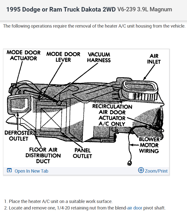

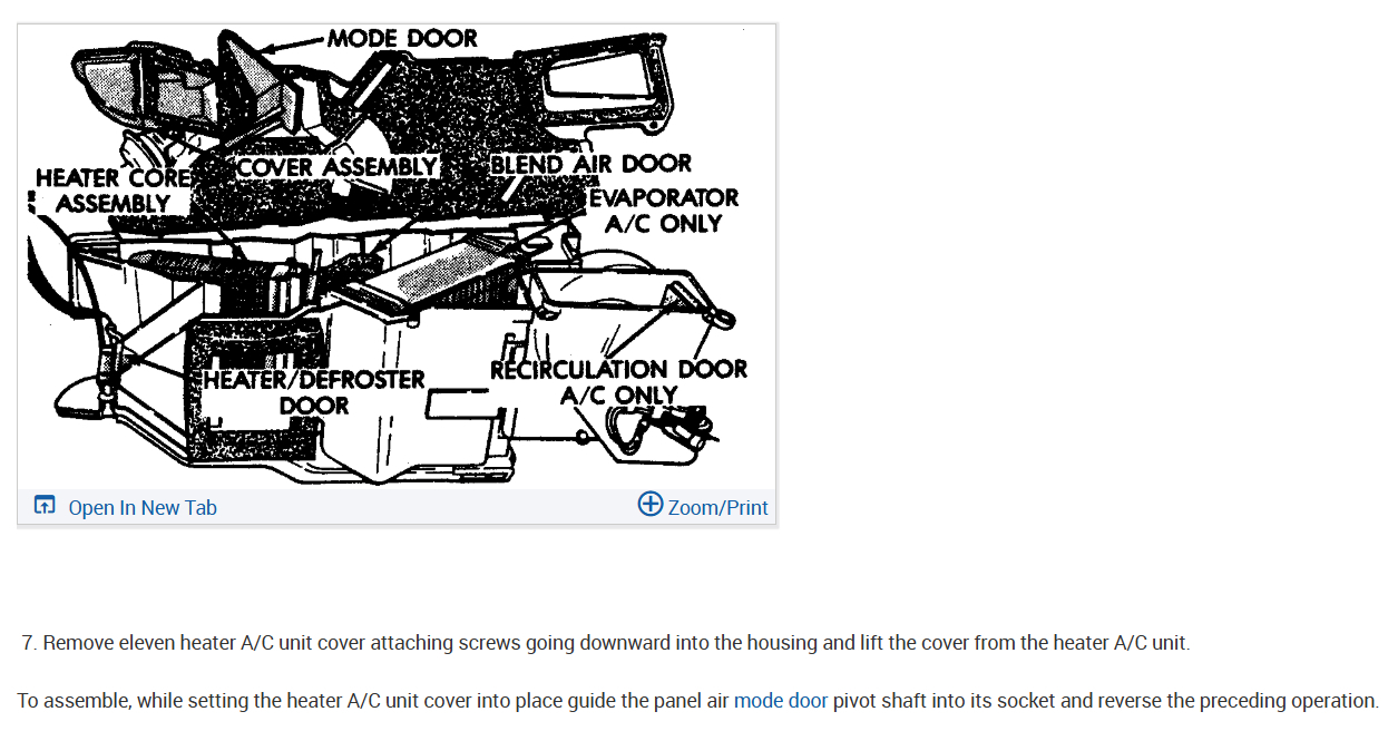

Here are the blend door locations which are vacuum operated. Check out the images (below). Let us know if you need anything else.
