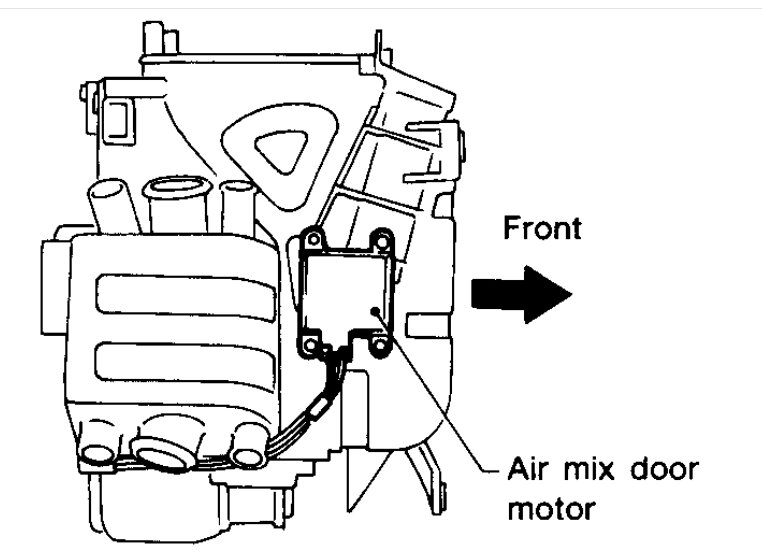

Where is the Blend door actuator located?
1994 NISSAN ALTIMA
251,000 MILES • 2.4L • 4 CYL • 2WD • AUTOMATIC
DENISE KAPPELE
Unable to locate blend door actuator location for my year/model. Fan blows cool with temperature on cold, when I slide to hot it starts clicking in dash and no heat.

The air mix door actuator should be on the passenger side under the dash. I was able to find a general pic from my manual showing its location.
Take a look at the pic and let me know if it helps. Note that the arrow in the picture is pointing toward the front of the vehicle.
Let me know if this helps.
See pic below.
