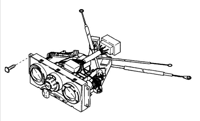

blend door actuator location?
2001 KIA RIO
123,000 MILES • 1.5L • MANUAL
WILL665
ac blows out the heater vents
Jul 11, 2026 at 5:35 PM
  • 55,381 POSTS
Yep, this is because there is no mode actuator on the car, it is run by cables. Here is the job being done on a similar car, the procedure is the same.
https://www.youtube.com/watch?v=Kawt1EodtFI
Check out the images (below). Please upload an image or a short video in your response, so I can see what's going on.
