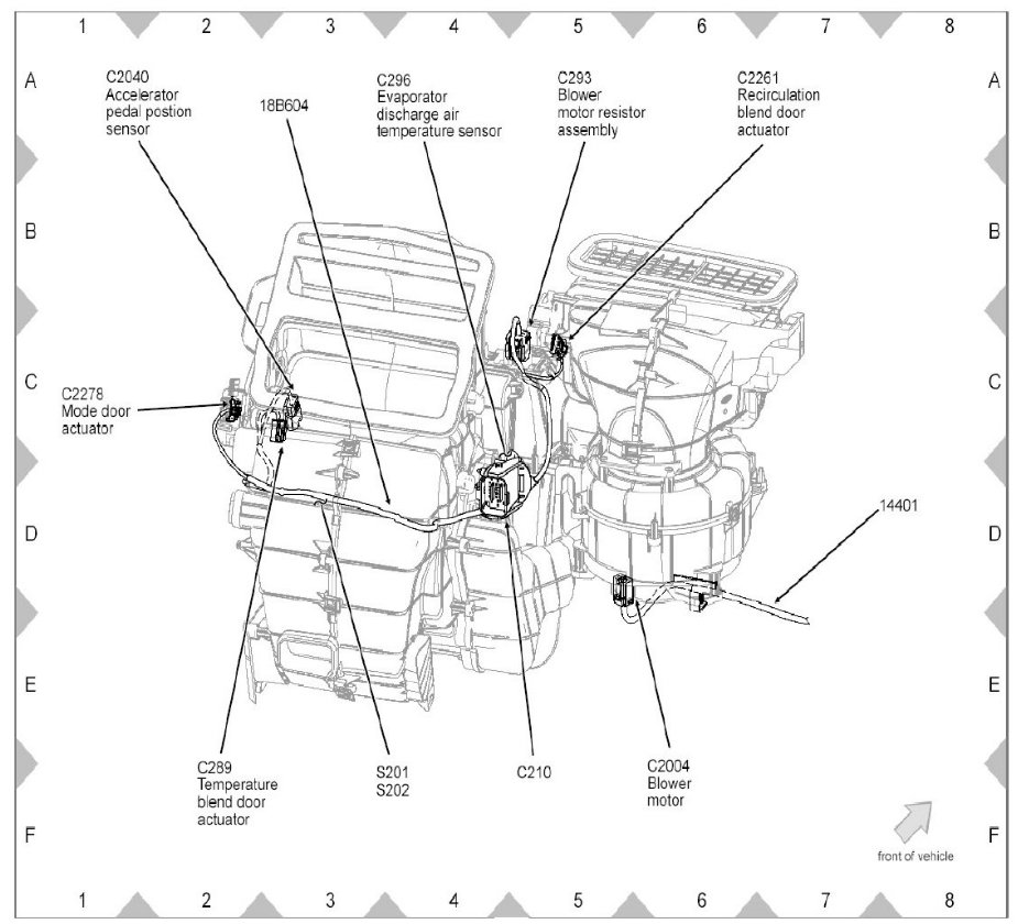

Can anyone advise me on where the blend door actuator located in Ford focus 2008 model, I just need to check it since my heater is not working

This could be your blend door actuator. I have included a diagram with the component's location in the diagrams below as well as a link with a troubleshooting guide for you to go through below as well.
Please let us know what you find out.
