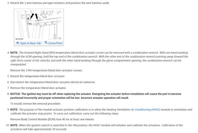

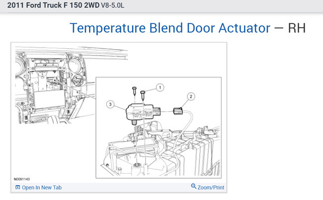

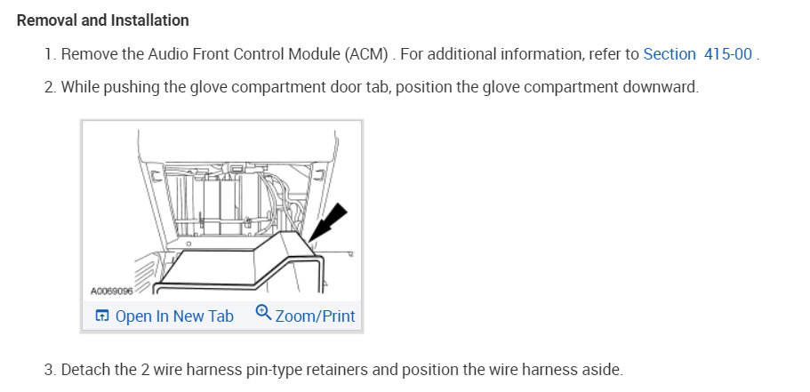

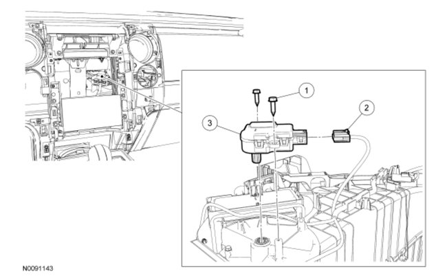

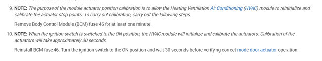

Yep, it sounds like the passenger's side blend door actuator is bad here is the location of the actuator so you can change it out in the diagrams below. It will need to be programmed which is done with no tools or computer, it is a simple procedure. Check out the diagrams (below). Please let us know if you need anything else to get the problem fixed.

I replace the passenger side and it still only blows warm air. Also, I followed the procedure to be programmed and still no change has happened.
