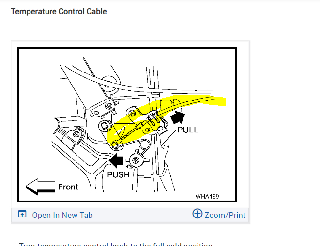

I need to know where the location of the blend door actuator is so I can check it. My A/C is only blowing hot heater air.

The air mix actuator is cable controlled. It is located under the dash approximate center. I attached a pic below. Locate the cable in the pic and manually change the air temperature knob to see if the cable is moving the lever.
Let me know what you find.
