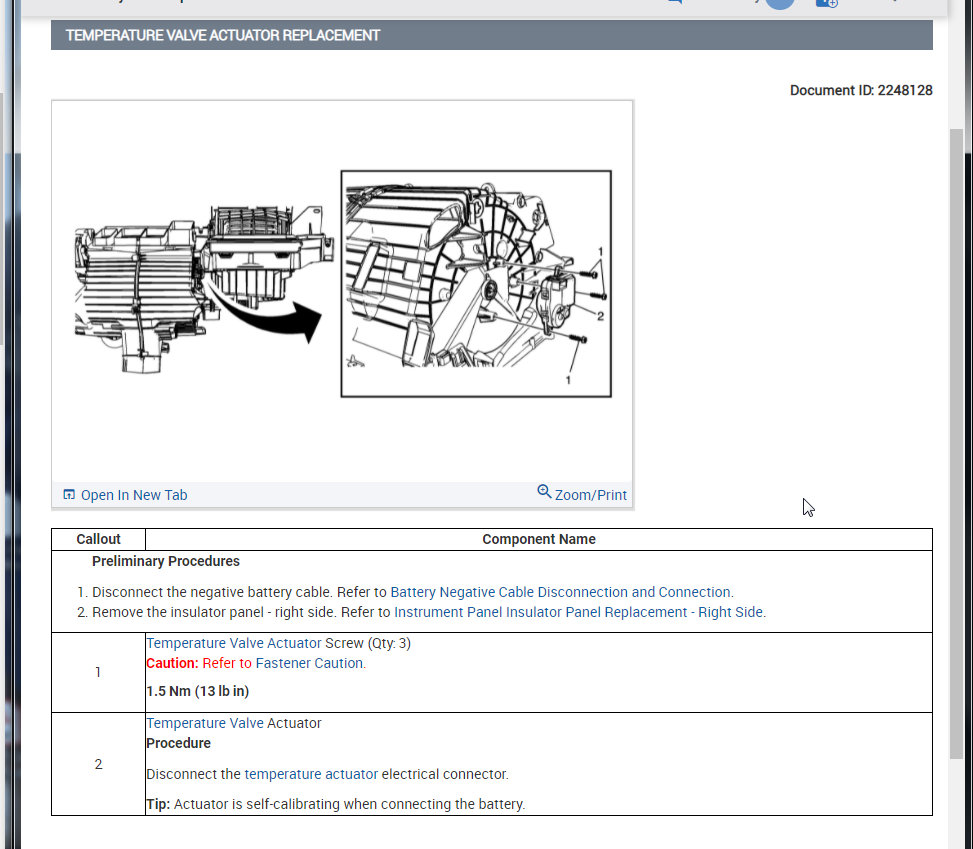

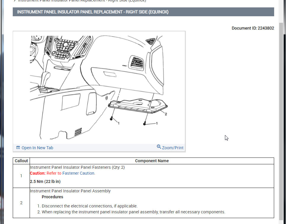

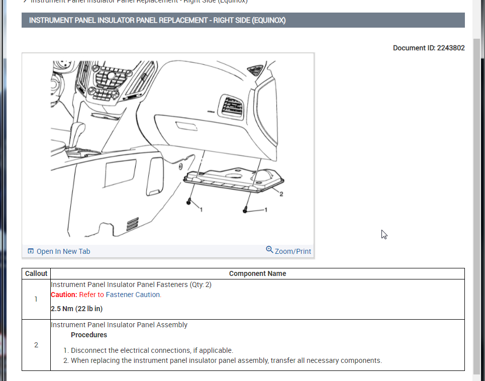

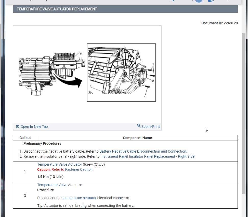

Hi, I am wondering how to remove a blend door actuator and what tools I would need to remove and replace?

Here is a guide that will help with step by step instructions on how to do this:
Below you will find the process from the manual which will give more detail on this.
Please run through this material and let us know if you have other questions on this. Thanks
