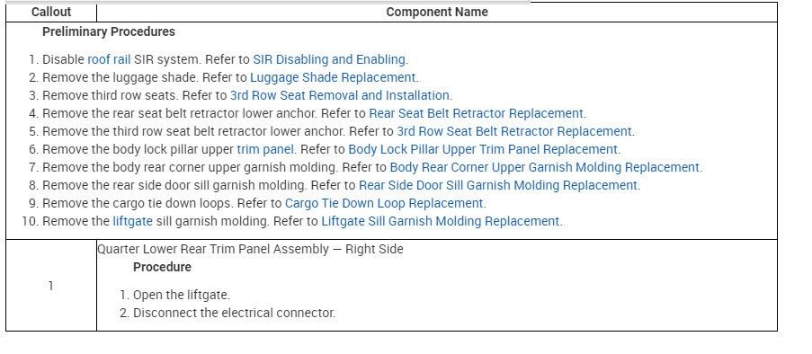

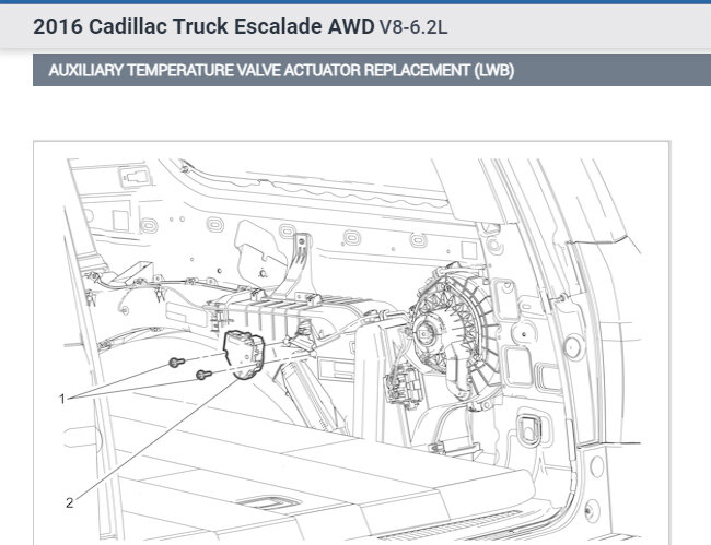

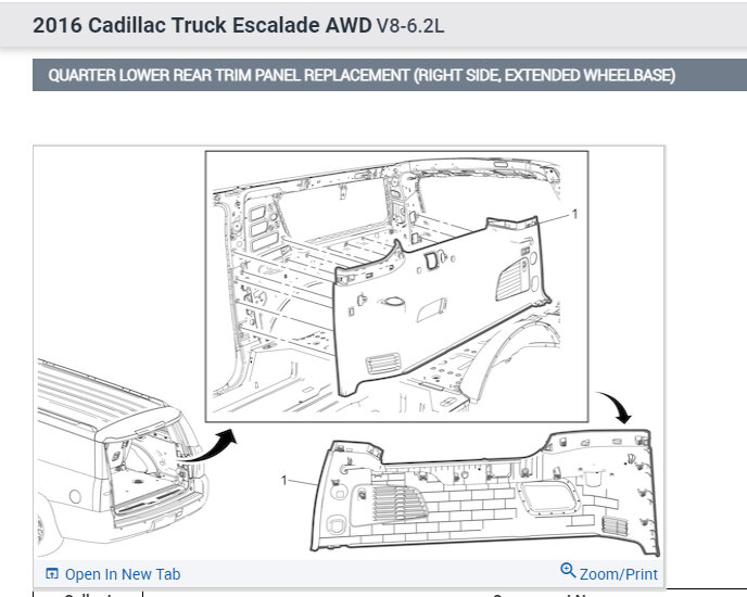

The rear of the SUV only blows hot air, A/C does not blow cold air in the back seats. I would like to know the location of the rear blend door actuator on the vehicle listed above and the steps to replace it.
Apr 18, 2023 at 11:03 AM
  • 110,248 POSTS

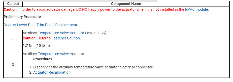

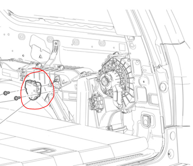

The actuator is located on the passenger side behind the rear trim panel. The panel will need to be removed for access.
If you could, let me know if this is a standard wheelbase vehicle or an extended wheelbase so I know which directions to provide for panel removal.
As far as the actuator, pic 1 below shows the location. The remaining pictures are the directions for the removal and replacement of the component.

It is the extended wheel base. I would greatly appreciate directions for panel removal.
Thank you
Danny
Apr 20, 2023 at 5:04 AM
  • 110,248 POSTS

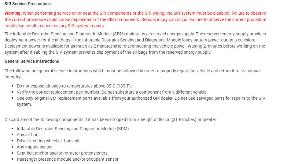

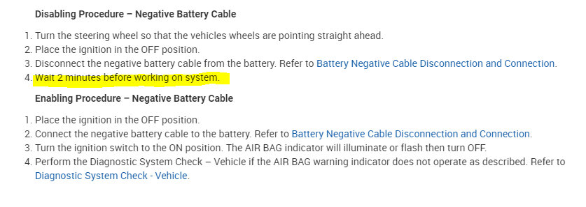

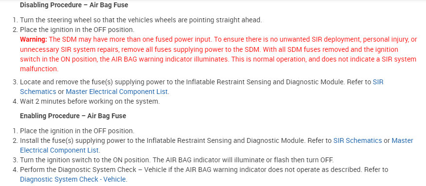

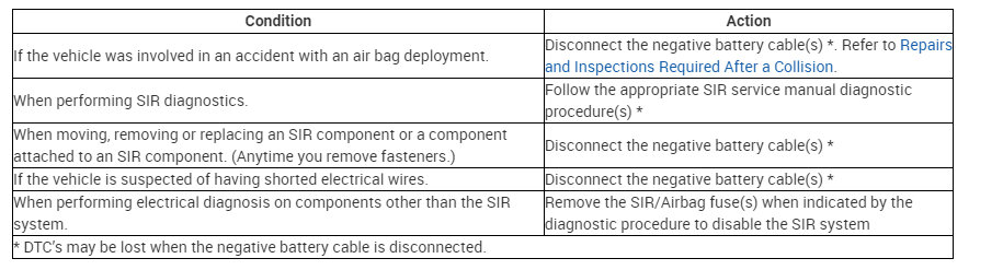

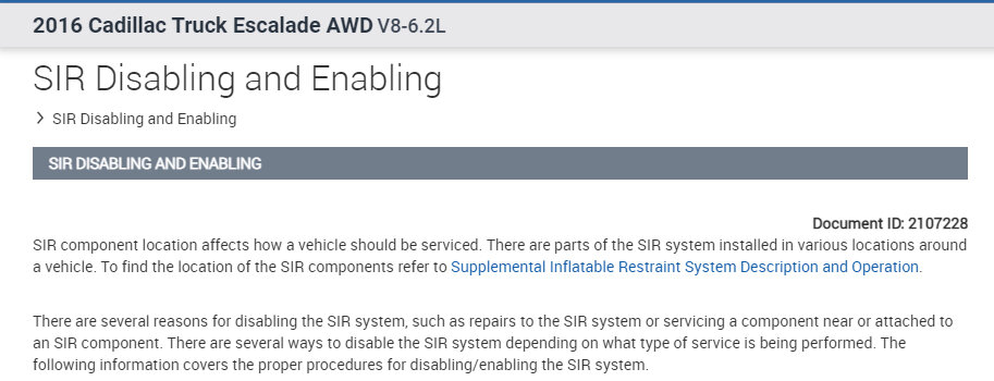

Hi Danny, the first two pics below are the directions for removing the panel on an extended-length vehicle. The one concern I have is the SIR needs disabled. I attached those directions after the panel info.
Make sure to follow the directions when working with air bags (SIR).
