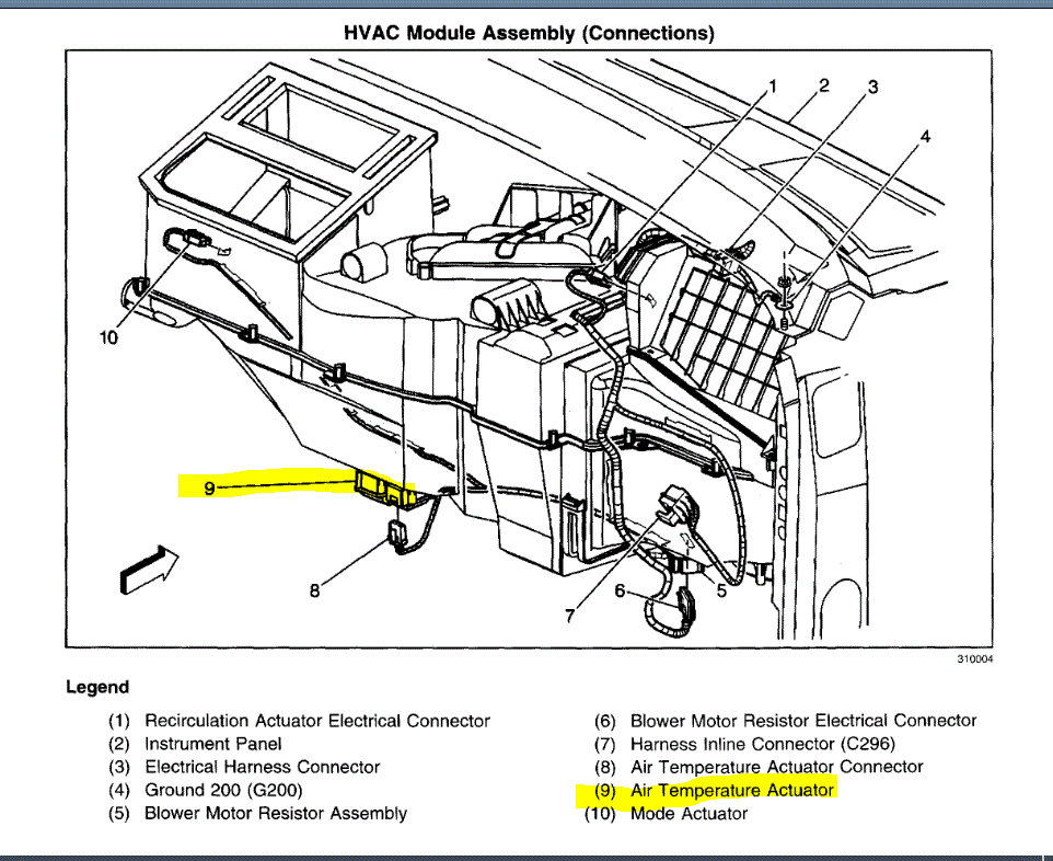

Was wondering how many actuators do I have in my vehicle? Thank you
Aug 1, 2020 at 1:38 PM
  • 110,240 POSTS
If you are referring to only the blend door actuator, there should only be one. I attached a picture below of it's location.
Here is a link that shows in general how one is replaced. If you want specifics, let me know if you have automatic climate control or manual.
