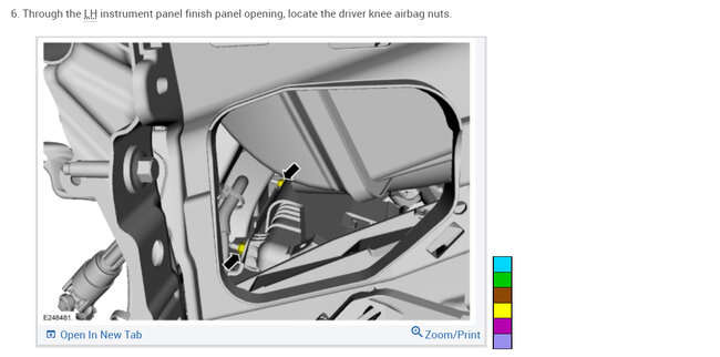

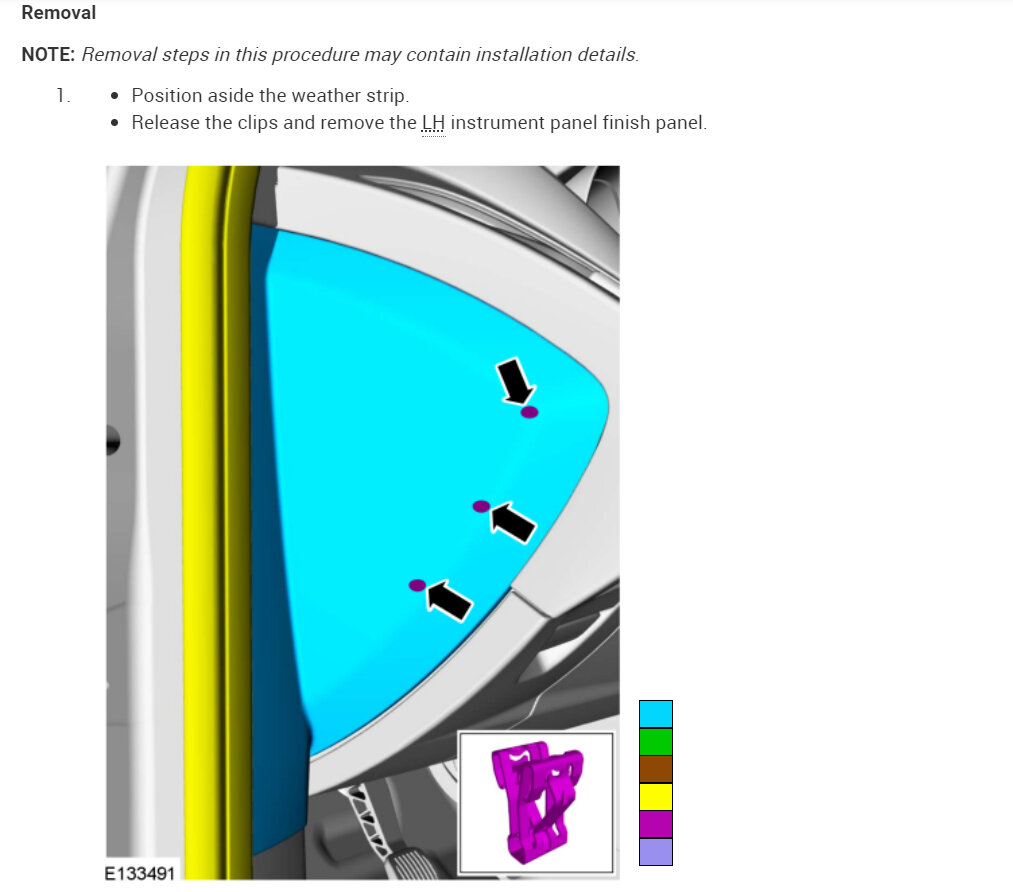

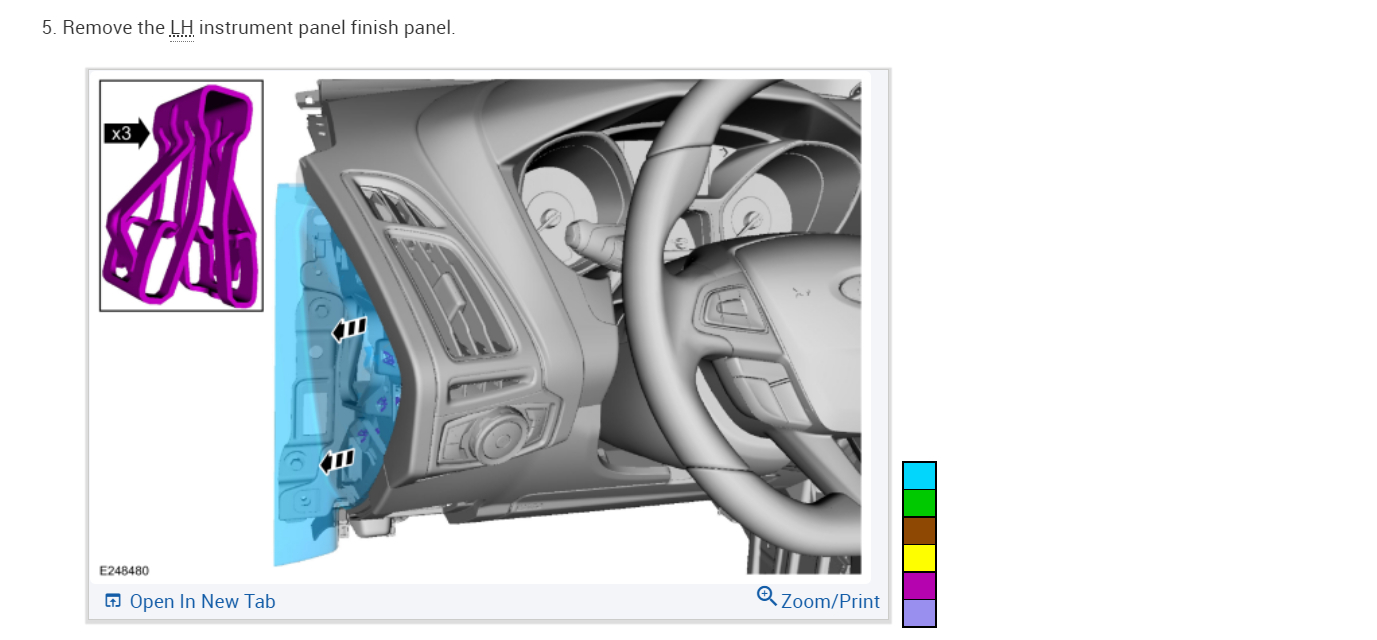

So, my blend door actuator went out recently, and I'm wondering if it's close to or identical to the way the Fusions are. I don't have dual climate control. Is there any way I could get diagrams of the teardown process?
Dec 14, 2022 at 10:28 AM
AL514
  • 5,587 POSTS

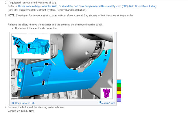

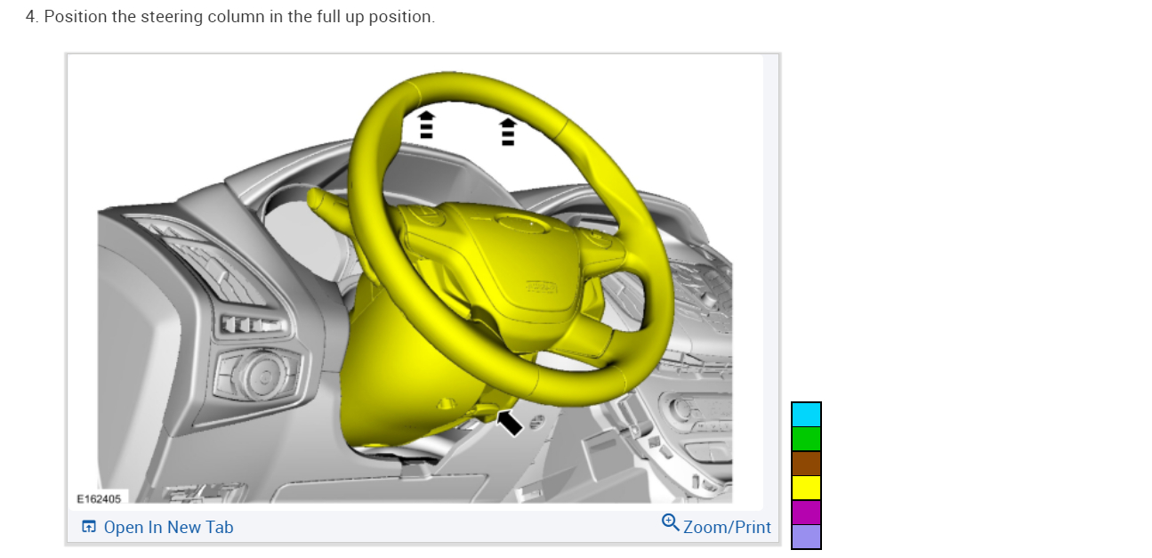

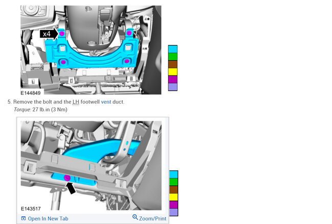

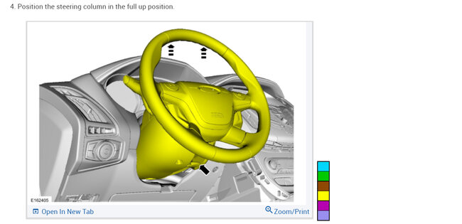

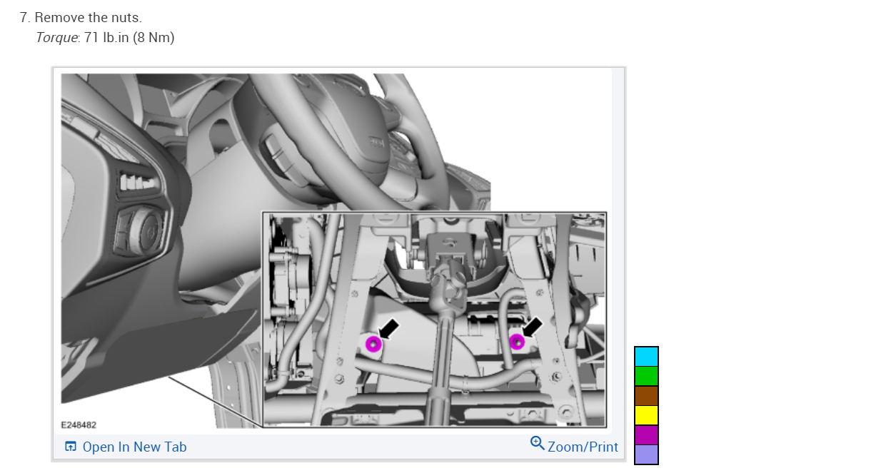

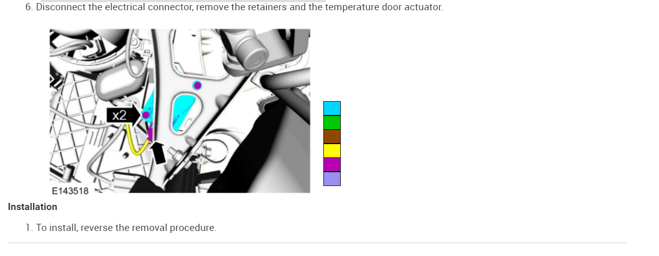

Hello, is this the Temperature Blend door you're referring to? Not the Air distribution door.

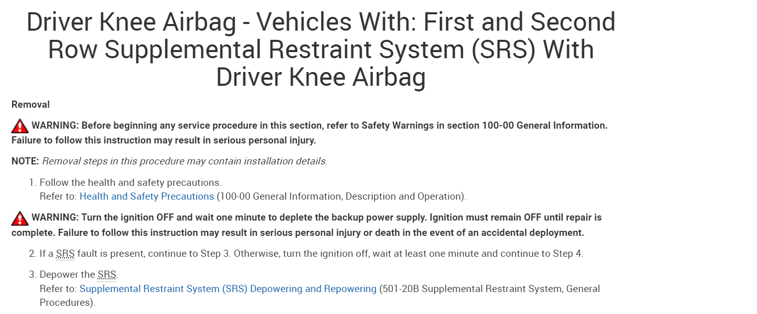

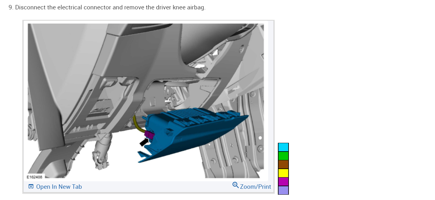

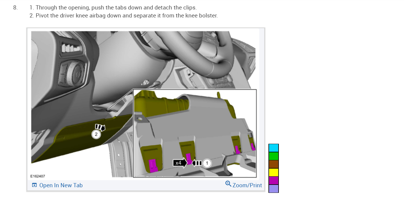

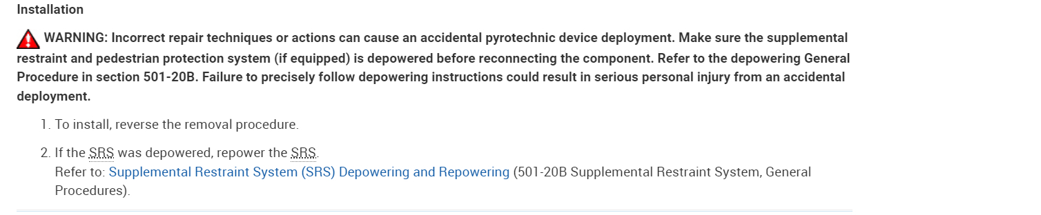

The temperature door actuator looks pretty easy, just need to be aware of any Driver Knee Airbag if it's equipped with one. I will post the knee air bag service info as well.
