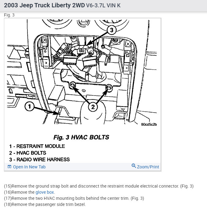

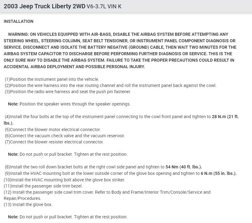

Blend Door actuator location needed.
Jun 3, 2022 at 4:46 AM
SQM
  • 6,383 POSTS

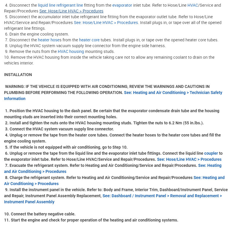

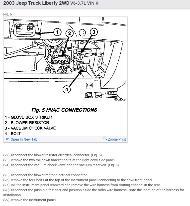

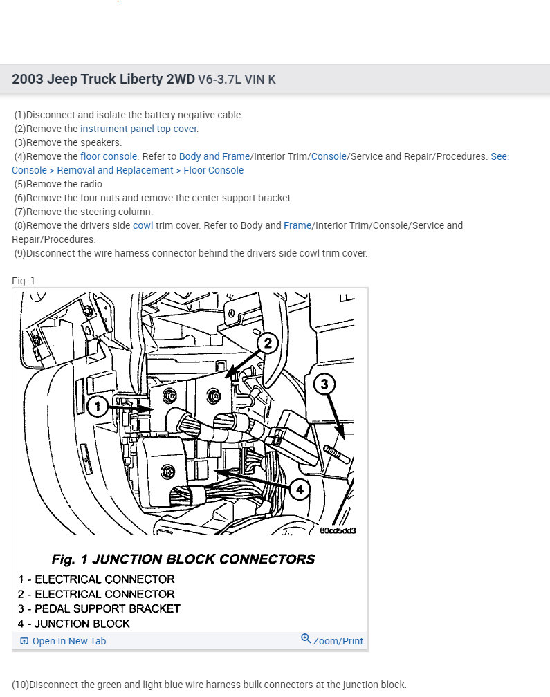

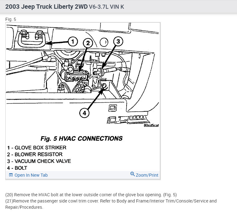

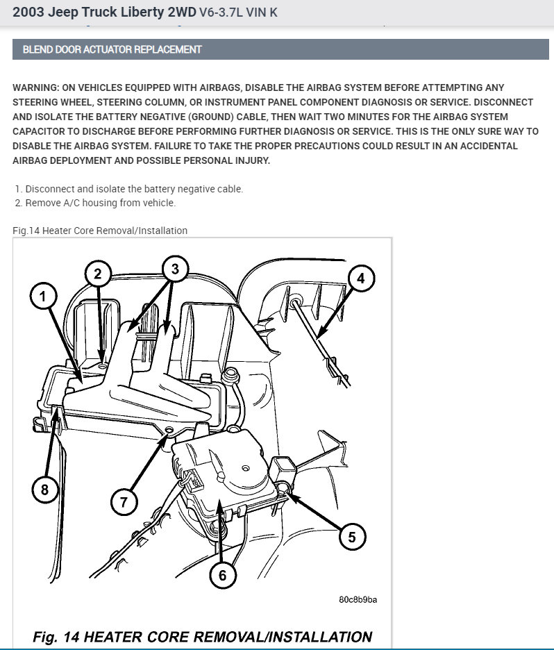

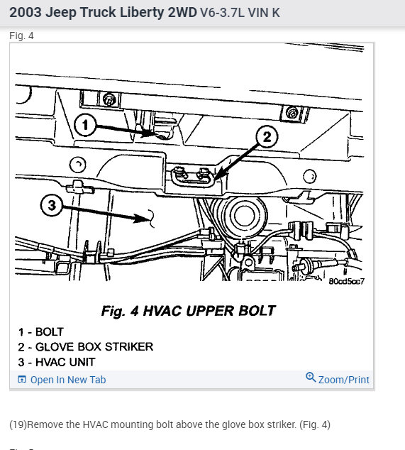

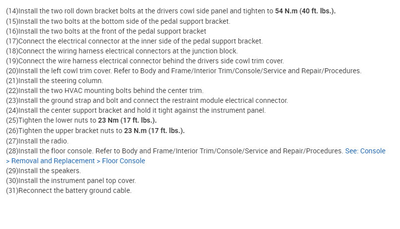

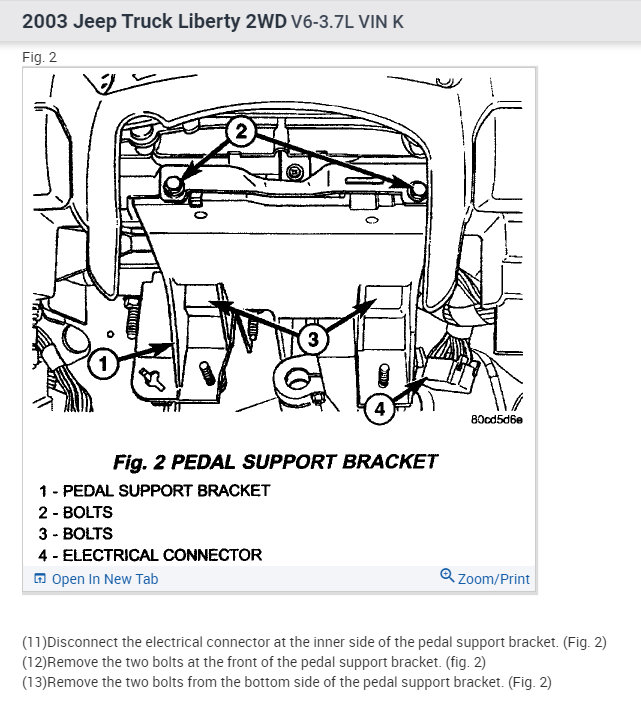

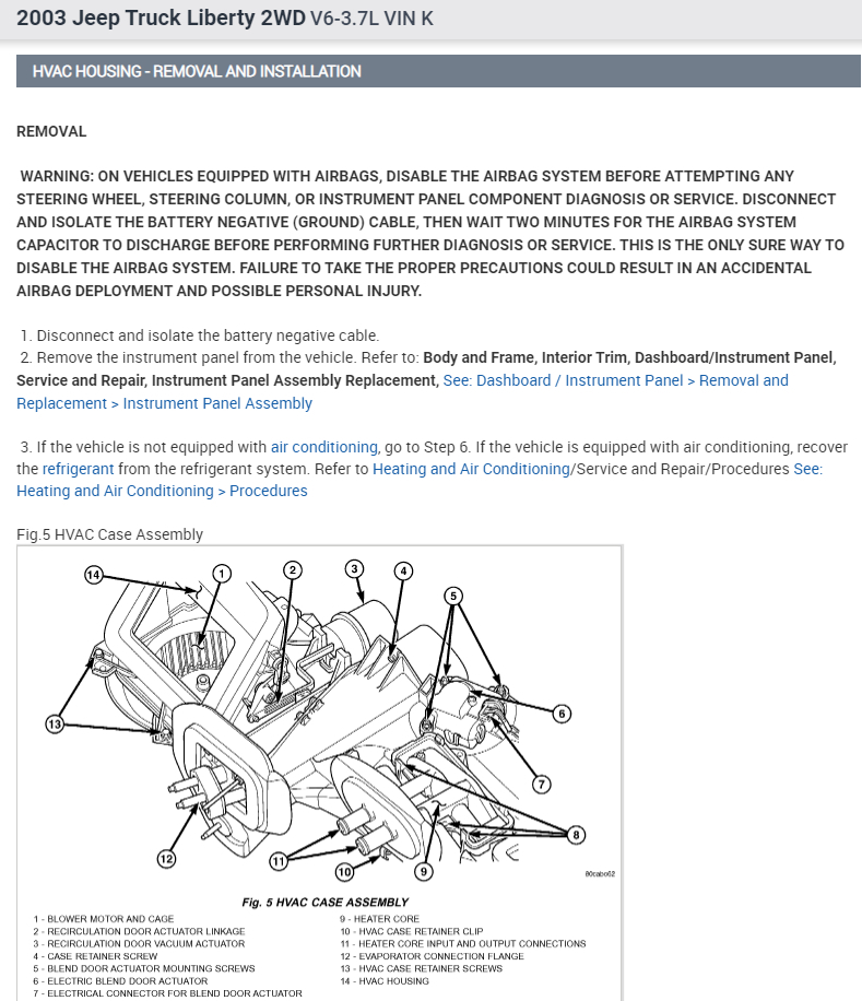

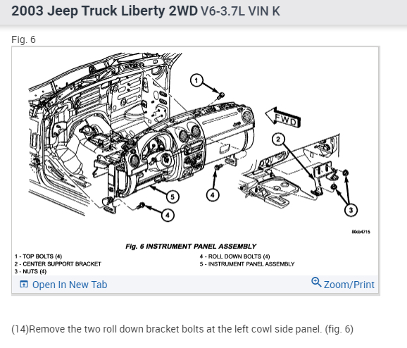

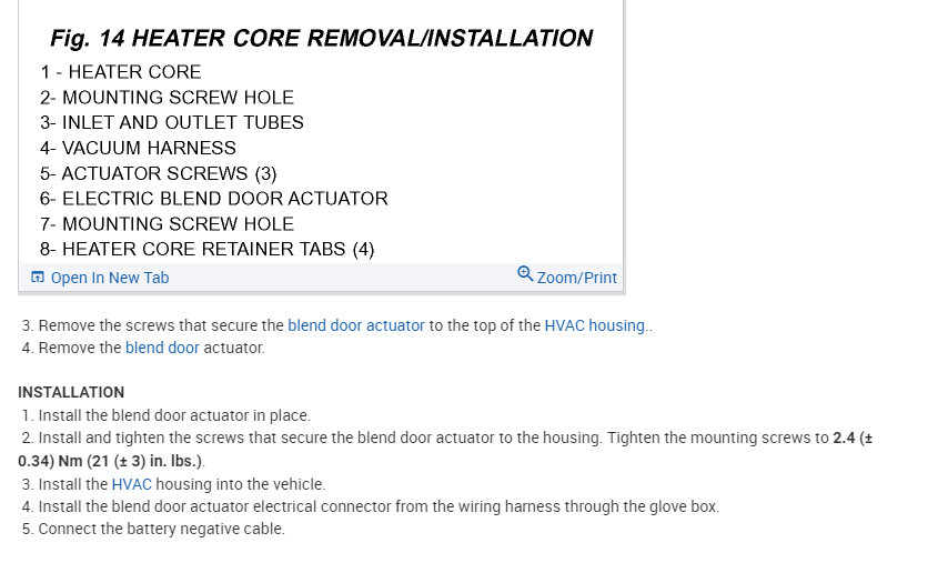

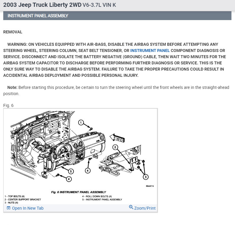

The blend door actuator is located on the HVAC box, which is located behind the dash.
In order to access it you will have to remove the dash.
I have attached the procedure below for your reference.
Let me know of any questions.
