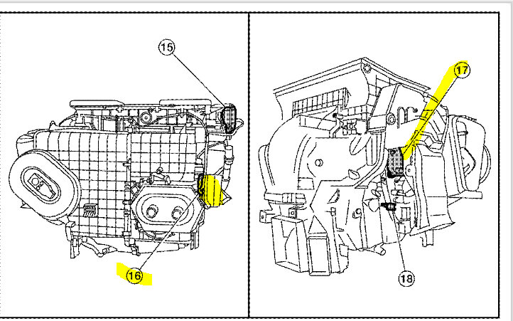

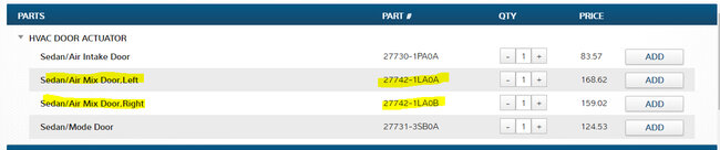

I have dual climate control in my car listed above SL. I turned the heat on and noticed the passenger vents are blowing cold air regardless of temperature setting. The driver's side blows warm air as expected. This very much sounds like an actuator issue.
Question 1. will there be two actuators which support the dual climate control or just one actuator?
Question 2. are there documented instructions for replacing the actuator for my model and trim level?
Nov 17, 2022 at 1:18 PM
  • 110,248 POSTS

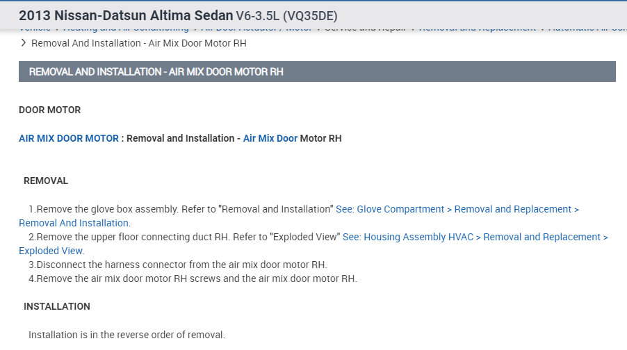

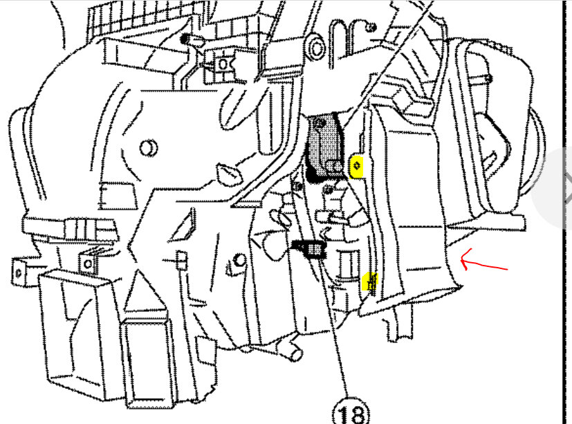

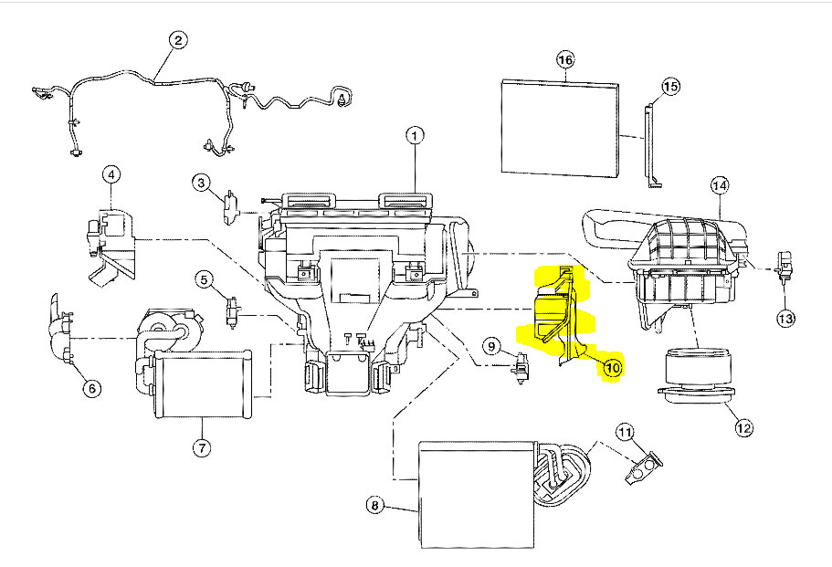

I'm glad to see that you reposted. LOL As far as your questions are concerned, there are two actuators. One controls the driver's side and the other is for the passenger side. If you look at pic 1 below, number 16 is the driver's side and 17 is for the passenger side.
I am basing this on you having automatic climate control. If you don't, let me know.

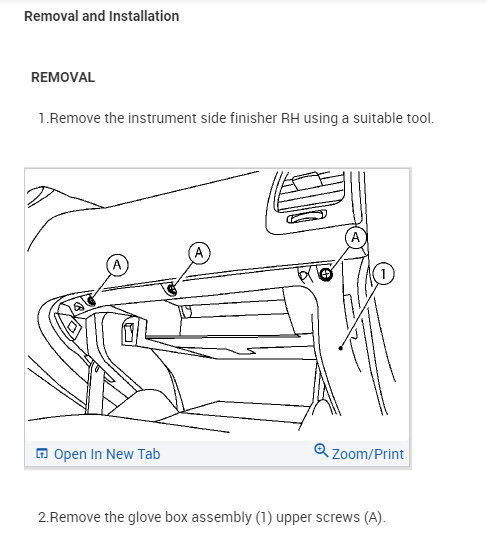

Pic 2 are the directions for replacement. You will need to remove the glove box to gain access to the actuator.

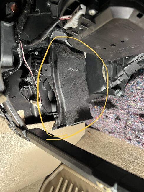

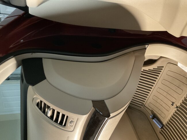

The last three pics are removal of the glove box, and I highlighted the heater duct that will need removed.

Is the actuator part identical for driver and passenger? Don’t want to mistakenly purchase the wrong side part. If you know the part number, that would be fantastic!
Nov 17, 2022 at 2:56 PM

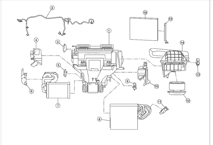

  • 110,248 POSTS
Believe it or not, it is showing two different part numbers. The only difference in the number is the last letter. Ugh!!! (See pic below) Also, the price is different as well. Keep in mind, the prices you see are original equipment parts. You should find them for much less. My only suggestion is not to purchase the least expensive thing you can find online. In most cases, they usually don't work or last about a week.
Take care and let me know how things turn out.

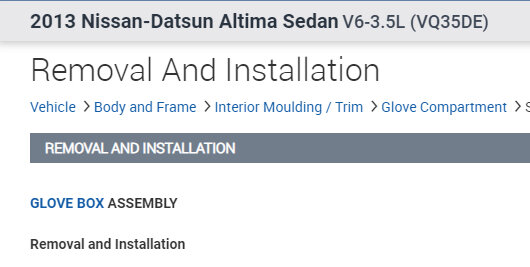

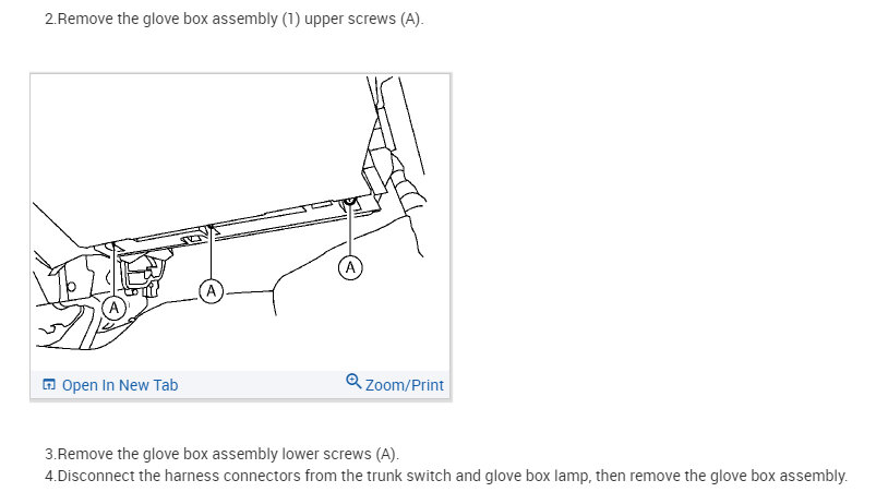

Do you have detailed instructions for removing the glovebox?
Dec 11, 2022 at 1:11 PM
  • 110,248 POSTS

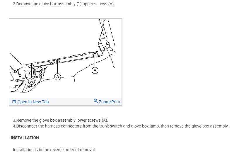

I do, if you look below, they are attached. Note, it will indicate the removal of lower screws. It can be a little difficult to see if you aren't at the correct angle.
Let me know if this helps.

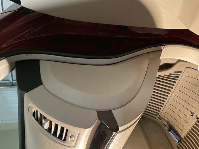

How does the side panel pop off?
Dec 12, 2022 at 6:07 AM
  • 110,248 POSTS
That is held on with clips. The reason the directions indicate using a suitable tool is that they don't want to be responsible if you scratch it. LOL
I use a flat screwdriver to get it started. I cover the screwdriver with a soft cloth and gently pry out on one end of the panel. Once it comes out far enough, grab it with your fingers and gently remove it.

How does this come off?
Dec 20, 2022 at 1:11 PM
  • 110,248 POSTS
The dashboard side panel is clipped in place. Take a flat screwdriver and cover it with a soft cloth. Then, gently pry the cover off.
As far as the duct in your last pic, it is clipped in place as well. I don't recall there being any screws. See pic below.

Thanks. I got the side panel off previously with a cloth covered flat screwdriver. Got the glove box removed. Found where the actuator is but can’t get the screws out because the passenger floor duct is in the way. Does that unclip from above? I could not locate it.
Dec 21, 2022 at 10:55 AM
  • 110,248 POSTS
For whatever reason, there are no directions in the manual. From memory, there are three clips. See pic below. Once they are detached, the duct should pull away from the distribution box. Actually, there may be just one clip.
Let me know if you have any luck.
See pic below.
