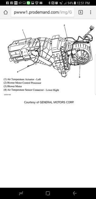

Is there more than one blend door actuator? My drivers side intermittently blows hot regardless of setting while the passenger blows cold. I see a "how to" on replacing but wanted to make sure which one needs replacing.

If you have dual climate control then yes you habe two different blend door actuators.

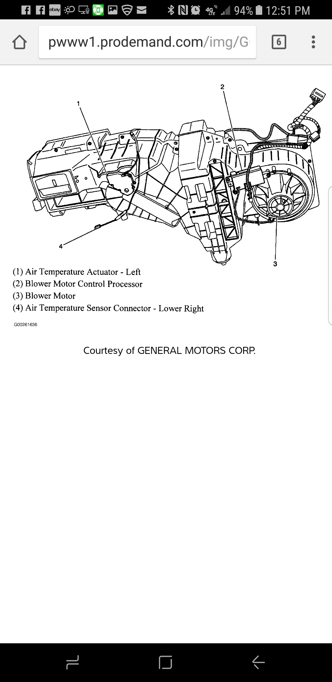

Where is the drivers side blend door? The how to only shows the passenger one I think.

It's number one in the diagram it's pretty easy to get to there is a cover you remove to access it.
