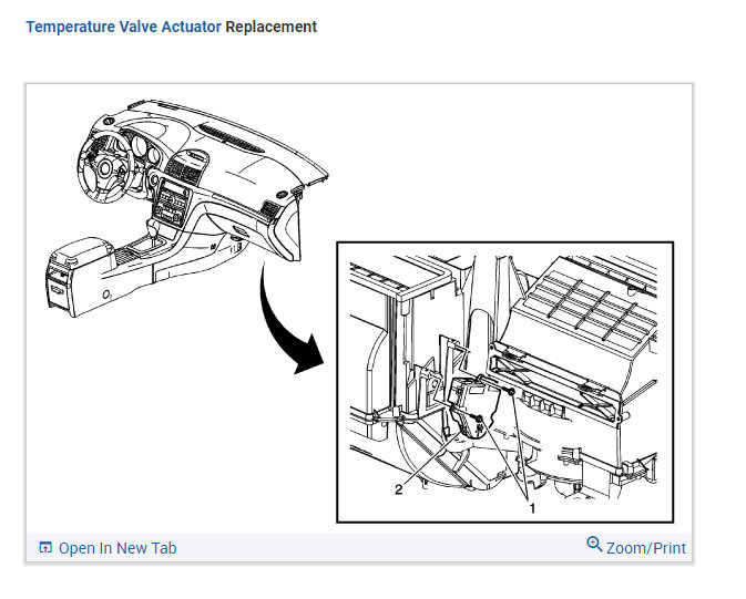

Blend door actuator removal instructions needed
2011 CHEVROLET MALIBU
90,000 MILES • 2.2L • 4 CYL • 2WD • AUTOMATIC
MR.HONDA24
  • 39 POSTS
Any techs share a repair manual/Alldata pdf on part explosion and/or getting the entire dash off.
I believe I have a failing blend door.
Dec 16, 2020 at 7:51 AM

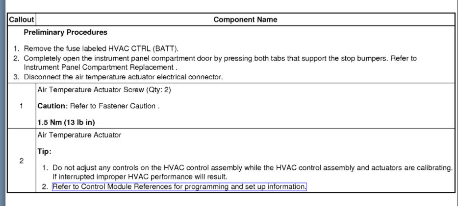

I may be missing something but I don't think you have to remove the dash on this vehicle. I attached below the process from Alldata. It says the glove box needs to come out and you should be able to reach it.
Also, here is a video on a GM truck that is similar to your vehicle. It is not exact but will give you a better idea of how to do this.
https://youtu.be/tY6M92fA2ug
Review this material and let us know if you have other questions. Thanks
