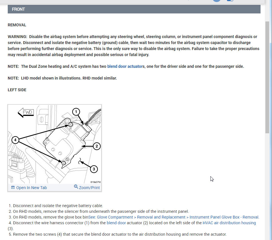

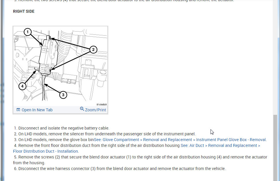

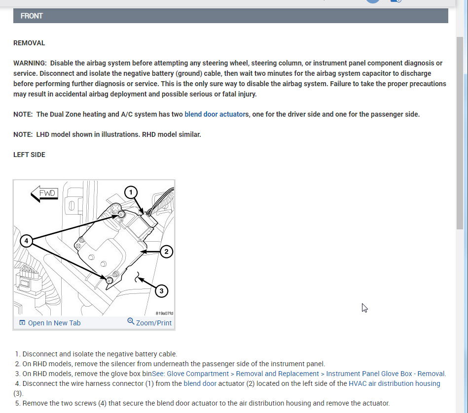

This vehicle has three. i replaced the one that controls air direction last year when it failed. Recirculation is working, air flow direction is working but having issues with heat. drivers side is warm passengers side is cool. which actuator controls heat?
Nov 16, 2020 at 10:47 PM
More then likely you have dual zone temperature control. Meaning you can move each side's temperature different then the other. If so, then you are going to need to replace the one on the side that is not moving to warm when it is set there.
Here is the process for both sides. Let us know if you have other questions. Thanks
