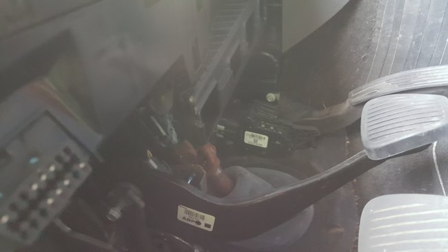

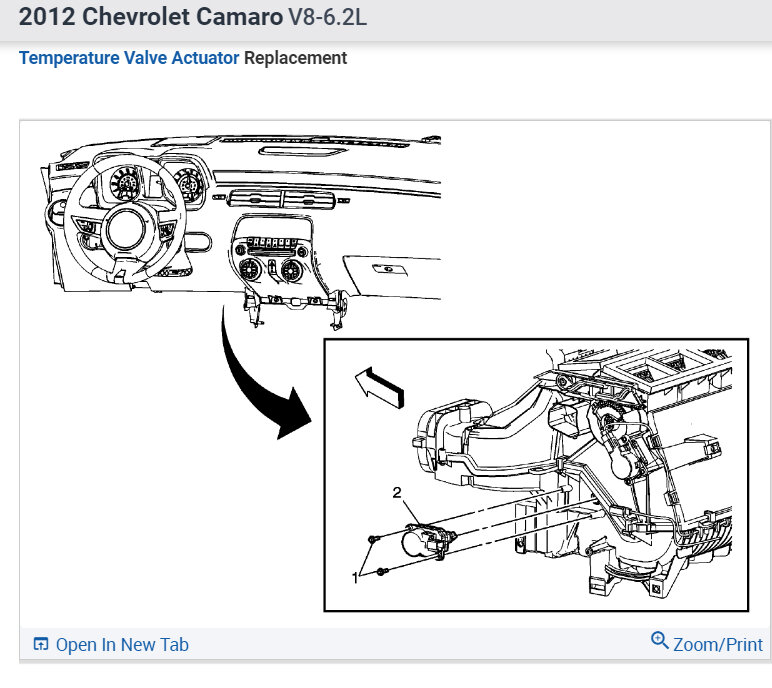

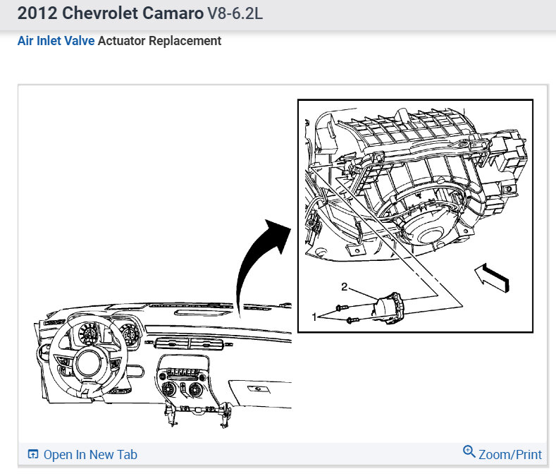

I am having the same issue described in your posting regarding the blend door actuator, however, my vehicle is listed above SS model. I have been searching the web to find the location of where the blend door actuator is located. Do you have a video or demonstration for my car?
May 28, 2018 at 4:25 AM
Good afternoon.

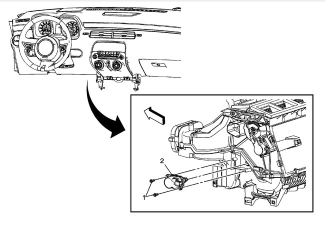

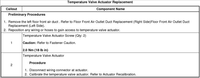

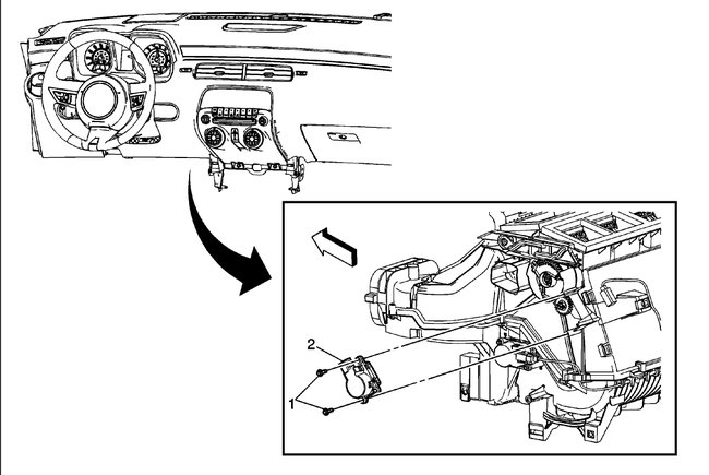

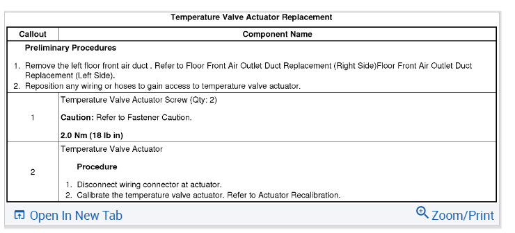

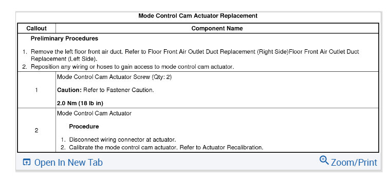

The actuator is under the drivers side dash above the fuel pedal. I attached a picture and procedure for you. Check out the images (Below). Please let us know if you need anything else to get the problem fixed.
May 29, 2018 at 2:24 AM
BSIERRAS
  • 19 POSTS
Thank you, Roy! I was not sure, but you have confirm it. The reason I could not be certain was apparently the other part (not sure of the name) that connects with the actuator has fallen. Any suggestions on how to connect without tearing up the inside to connect the two.

Yes, that is correct. Where the actuator attaches at, but not the electrical connection. Yes, I can upload a photo, but I will need some time to get it uploaded. Many thanks!

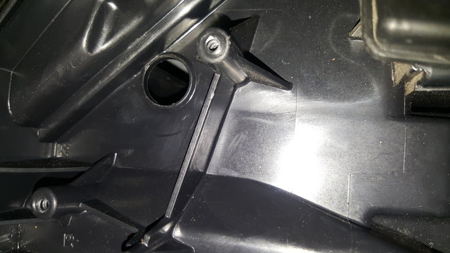

Hey Roy, I do not know what happen. I was certain I uploaded the image the day we have been corresponding. But here it is again. Many thanks! Have a wonderful day!
May 31, 2018 at 9:59 PM
  • 55,554 POSTS
It looks like there was something there at one time. Do you not have the part or the wiring? Is this a track SS? Some of these cars are stripped down. Do you have the old part and you are not weening the wiring? Please give more details.
Jun 4, 2018 at 3:44 AM
BSIERRAS
  • 19 POSTS
Hey, Ken.
Thanks for responding. I do have the blend door actuator, and I felt inside the hole, and there is something inside there. If you are asking if I have an SS, yes I do have an SS.
I was wondering how to be able to attach the actuator to the part that is on the other side of that barrier without having to tear open the dashboard.
Jun 8, 2018 at 8:45 AM
  • 55,554 POSTS

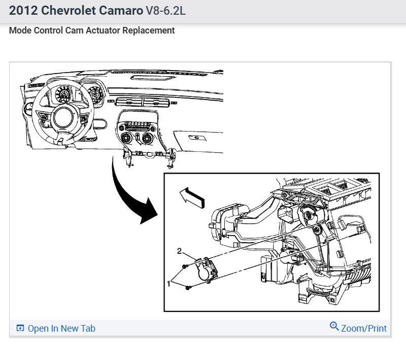

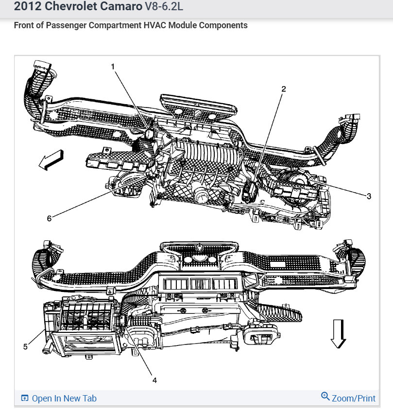

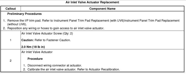

You should be able to. Here is a guide that can help with diagrams for what it will take in your car:

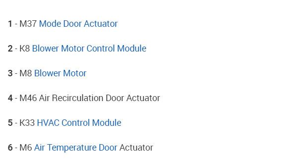

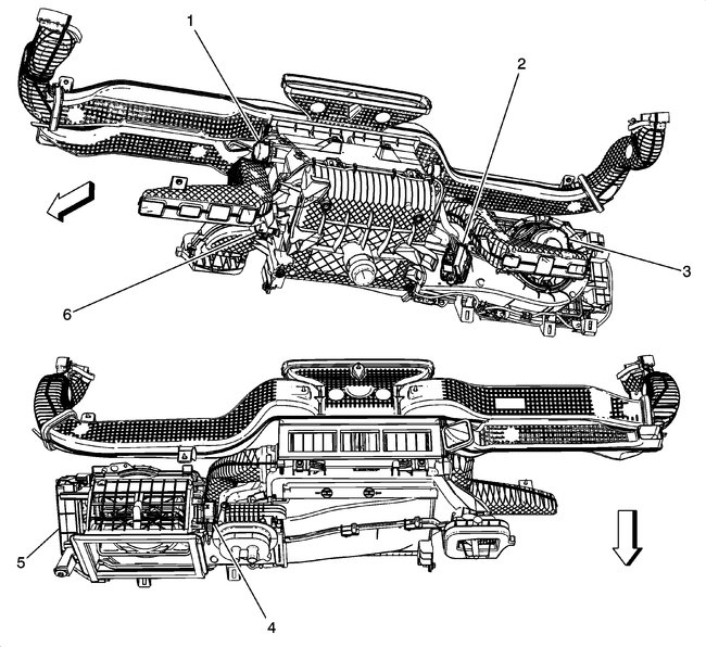

Here are all blend door actuators so you do not get mixed up (below):
1 - M37 Mode Door Actuator.
2 - K8 Blower Motor Control Module.
3 - M8 Blower Motor.
4 - M46 Air Re-circulation Door Actuator.
5 - K33 HVAC Control Module.
6 - M6 Air Temperature Door Actuator.
Jun 8, 2018 at 8:54 AM

It has been a while and I am still struggling with the issue. Thanks for the detail instructions. It was great but it seems that my blend door actuator comes from the driver side near the fuel pedal. Do you have instructions for attaching it to whatever is on the other side of the barrier?

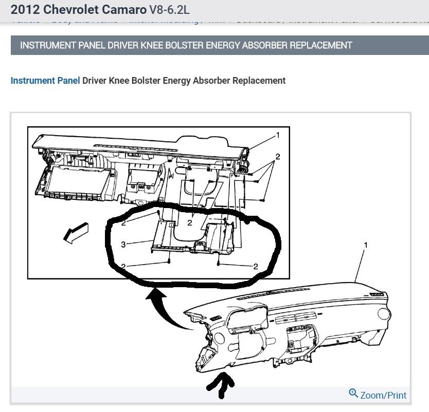

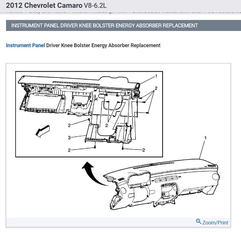

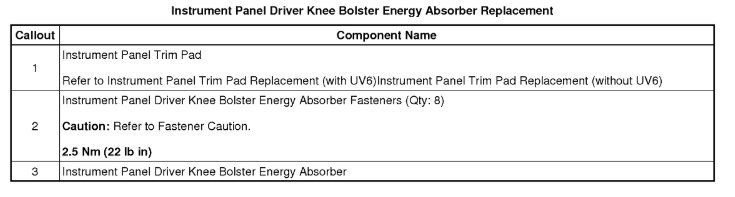

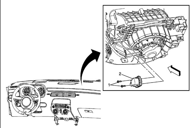

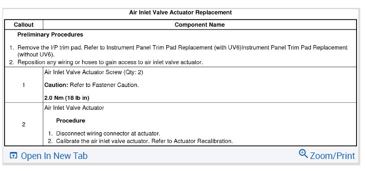

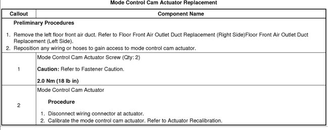

It will help to remove the knee bolster, here is a diagrams to help you see how. If this is not correct can you shoot a quick picture of the problem and upload it?
Aug 3, 2018 at 5:24 AM

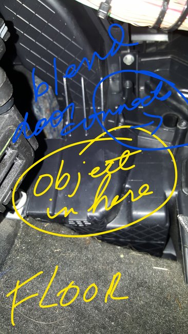

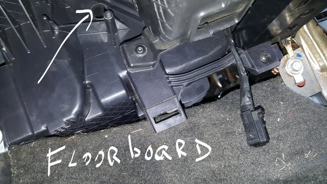

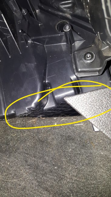

Here are some more photos to give you an idea of what I am up against. As you view the first photo, there is seperation from the floorboard and the part I am working with. I am trying to get into that part above the floorboard.
Aug 13, 2018 at 2:01 AM
That hole in the case is what concerns me. Where is the door hook up?
Aug 13, 2018 at 2:16 AM
BSIERRAS
  • 19 POSTS

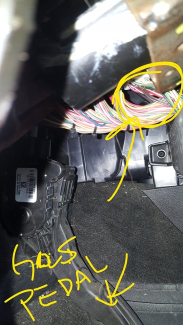

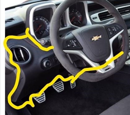

So, I tried using the diagram provided to remove panel driver knee bolster energy absorber, and I got stuck on a concern. By reviewing the photo attached, am I to remove everything that is within the yellow lines? I started to remove the studs and screws when I noticed that the panel goes upward. So I stop the procedure to inquire if I was on the right path.
Also, will removing this panel get me into the housing where the blend door actuator attaches?
Aug 16, 2018 at 3:24 AM
STEVE W.
  • 15,370 POSTS
The knee bolster close out is the panel underneath that area. If you put your head into the drivers foot well and look up at the area under the steering column you will see the panel you need to remove. There are 6-8 screws that come out and the panel drops down.
The blend door actuator is number 6, with the lower panel off it should be above the gas pedal area on the case, tucked into the area between the case halves.
Aug 20, 2018 at 3:48 AM

STEVE W.
  • 15,370 POSTS
Okay, went back through your information. From your description it sounds like the actual blend door has failed. They are nothing but a plastic flap with a pivot pin molded on two corners. One of the pivots goes into a hole in the case and the actuator connects to it, the other sets into a blind hole on the opposite side of the air passage. I suspect you have the same issue as the video, the door pivot broke off. If it dropped into the case there is no real easy way to get to it to fish it out and get it back into place. If it broke as I suspect getting it back into place will not really help as it would not stay in place and work.
The options are to cut the housing open, replace the door and glue the housing back together or remove the entire dash to remove the case and replace the door. Not really any other way. If you cut it open you do not need to worry so much about strength, you can always glue a section of plastic over the cut area as a reinforcement.
Aug 26, 2018 at 1:31 AM
