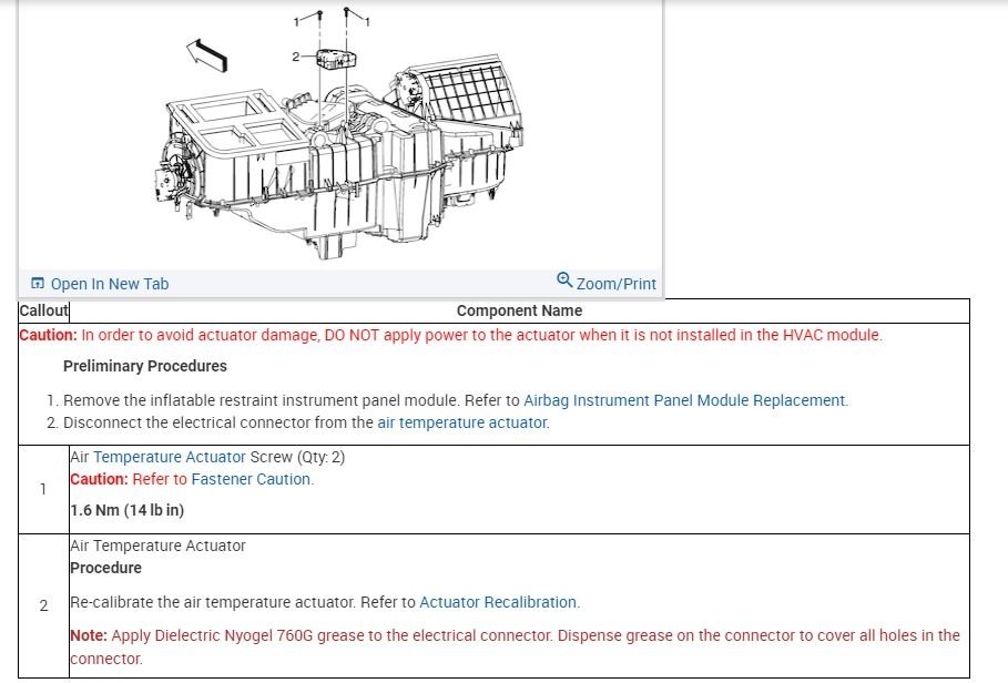

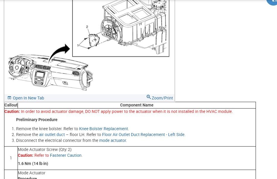

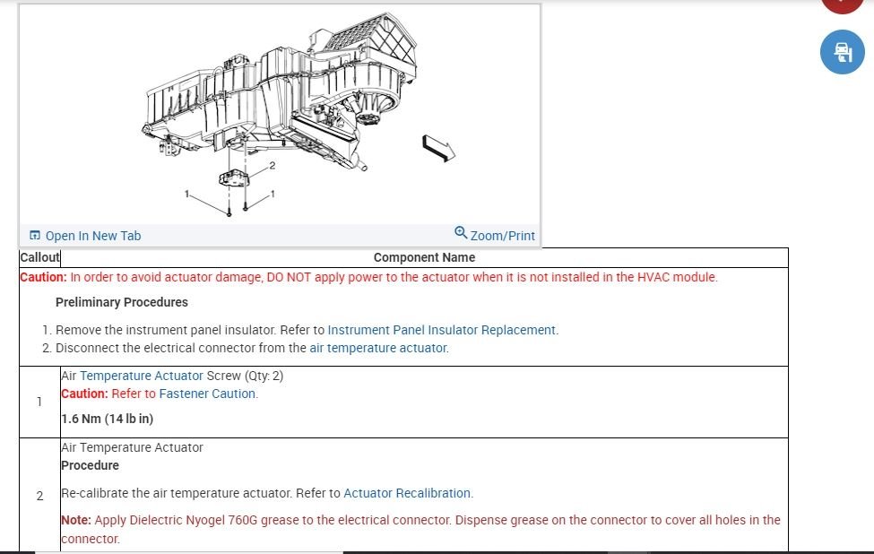

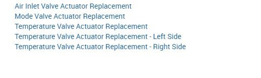

There are several actuators. Do you know which one? Try changing modes or temperature and see if the noise changes. That will help narrow the one that is making noise. this guide can help and video can help.
https://youtu.be/Eqf-H3COtSo
and
Check out the diagrams (Below). Let us know what happens and please upload pictures or videos of the problem.
Feb 12, 2021 at 5:37 AM
ART ROBITAILLE
I would have to say the first view. The sound is under the glove-box.
With the noise happening, put your hand on it and see if you can feel the ticking.
That will confirm it.
