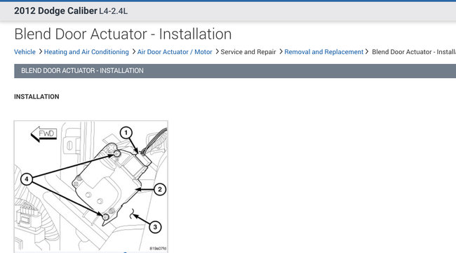

How many of these does the vehicle listed above have? I recently replaced one and now have another one gone bad. I need to order the part, but would like to replace them all since they are slowly all going out.
Feb 12, 2020 at 12:54 AM
SCGRANTURISMO
  • 4,897 POSTS

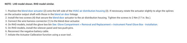

There are three actuators in your vehicle's Heating Ventilation and Air Conditioning [HVAC] system. They are the Blend Door, Mode Door, and Re-circulation Door actuators. The actuators are interchangeable with one another so no worries about purchasing the wrong actuators. In the diagrams down below I have included the instructions from the vehicle manufacturer for the installation of the Blend Door actuator to get you started. Please get back to us with how everything turns out.
