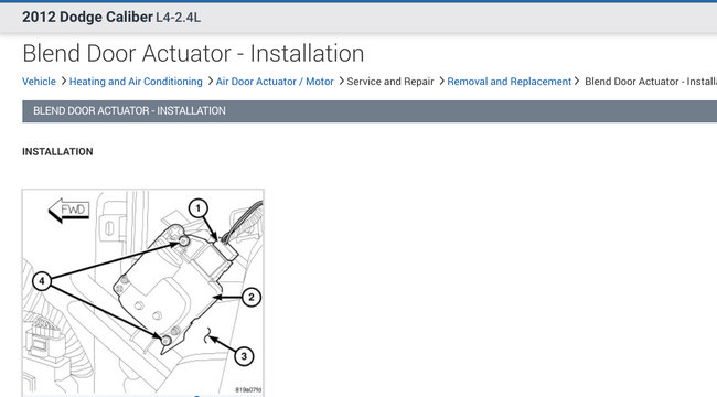

How many of these does the vehicle listed above have? I recently replaced one and now have another one gone bad. I need to order the part, but would like to replace them all since they are slowly all going out.

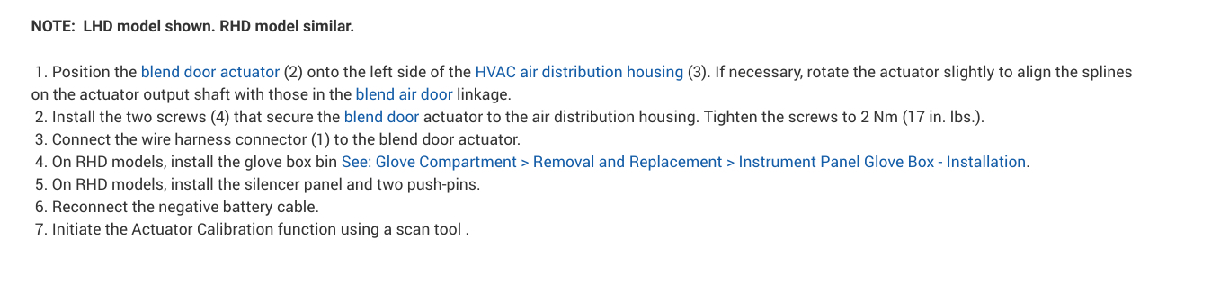

There are three actuators in your vehicle's Heating Ventilation and Air Conditioning [HVAC] system. They are the Blend Door, Mode Door, and Re-circulation Door actuators. The actuators are interchangeable with one another so no worries about purchasing the wrong actuators. In the diagrams down below I have included the instructions from the vehicle manufacturer for the installation of the Blend Door actuator to get you started. Please get back to us with how everything turns out.
