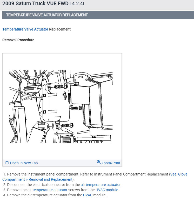

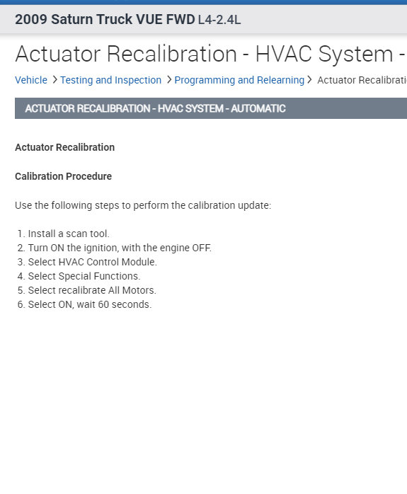

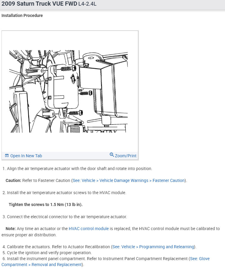

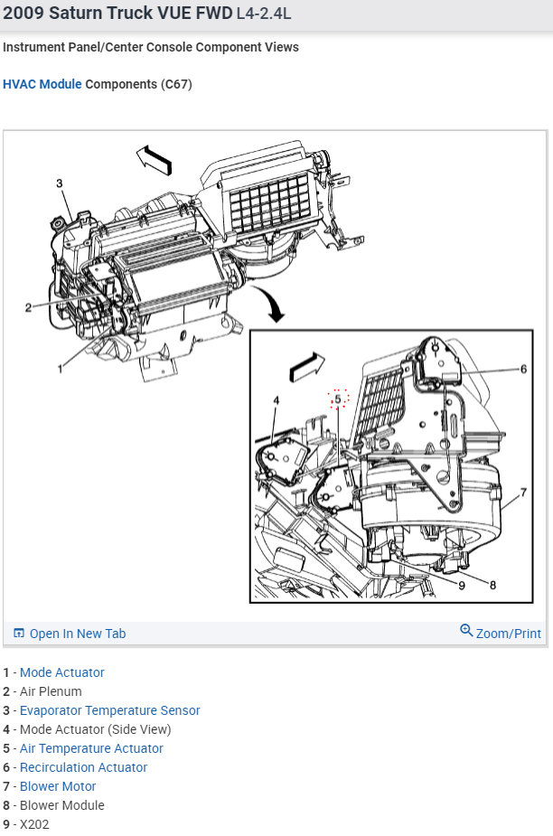

Does the actuator need calibration by the dealer or can you DIY? I have read both yes and no on the internet.
Oct 31, 2021 at 3:55 AM
SQM
Experienced Mechanic
6,383 POSTS
The calibration of the blend door actuator needs to be performed using a specialized scan tool.
I have included the instructions below.
