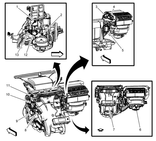

Location of this part because mechanic couldn't find it.

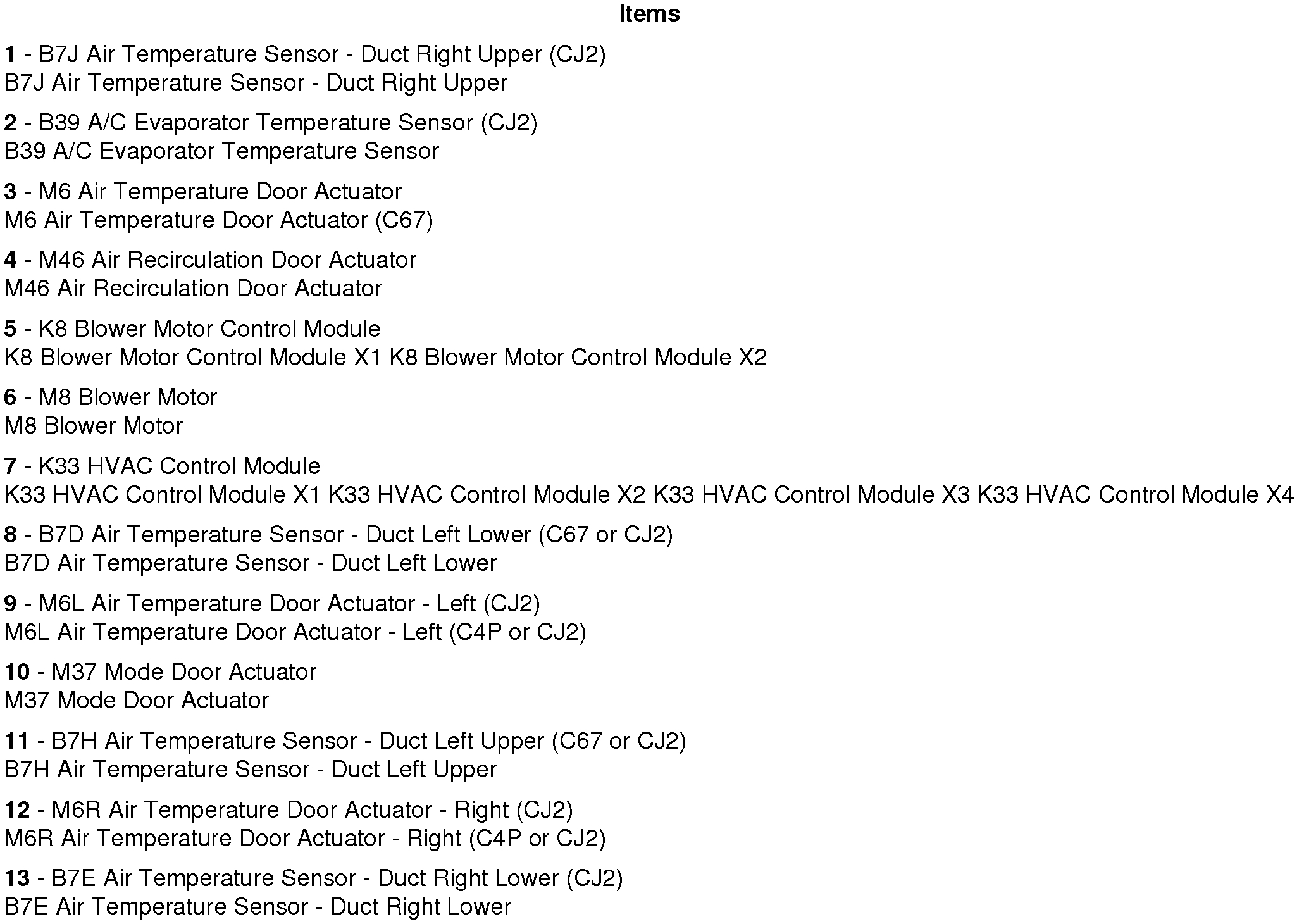

I attached two pictures. The first is an exploded view of the components related to the HVAC system, including the blend air doors. They are referred to as Air Temperature Door
Actuators. Picture 2 is a legend of the components in picture 1.
Let me know if this is what you needed.

My cars heater wouldn't work when I would warm up the car on cold days. It would start after a while when I would start driving. Which actuator of the ones that you send me is the one that is causing the problem? Changed one under the steering wheel on the upper right side and it didn't fix the problem. If you can give me some advice I appreciate it, thanks!

The actuator won't start working after you drive. Check to make sure the coolant is full. Also, you may want to try flushing the heater core.
