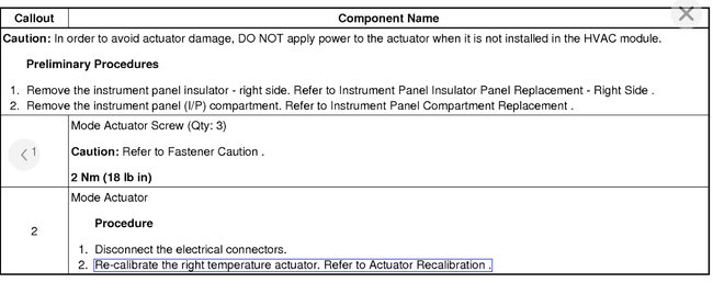

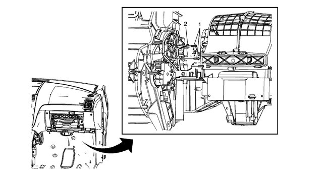

Only blows air from upper dash vents can't change but can switch rear on and off.
Dec 28, 2018 at 7:03 AM
  • CAR REPAIR CONTRIBUTOR
Good morning,
It sounds like you need a mode door actuator as that controls the movement of the mode door. this is a very common failure.
https://www.2carpros.com/articles/air-vents-stay-in-the-defrost-position
It is located behind the glove box on the passenger side.
