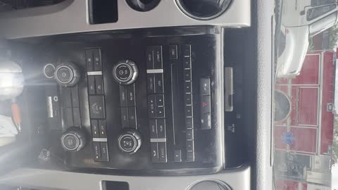

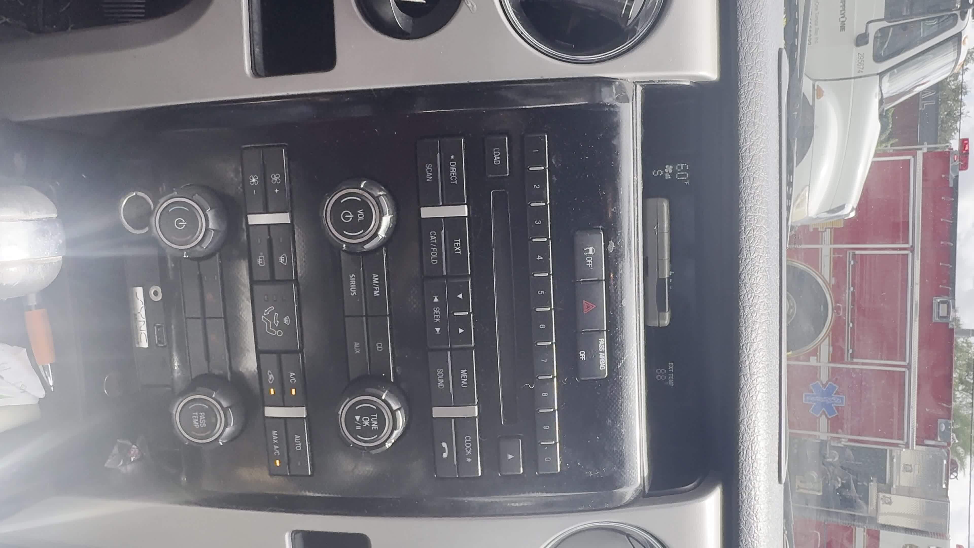

I have a 2011 fx-2 sport eco-boost. There is clicking behind my dash somewhere. I have dual zone climate control I believe. I see the part is cheap but depending on which one it is it can be very difficult to get to. Can you maybe point me in the right direction? So, when I’m running the A/C the driver’s side seems to stay cold while the passenger side fluctuated between cold and hot air. Any advice would help.

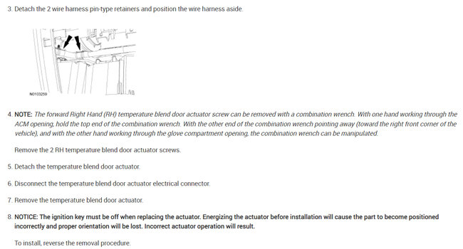

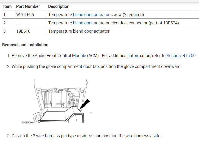

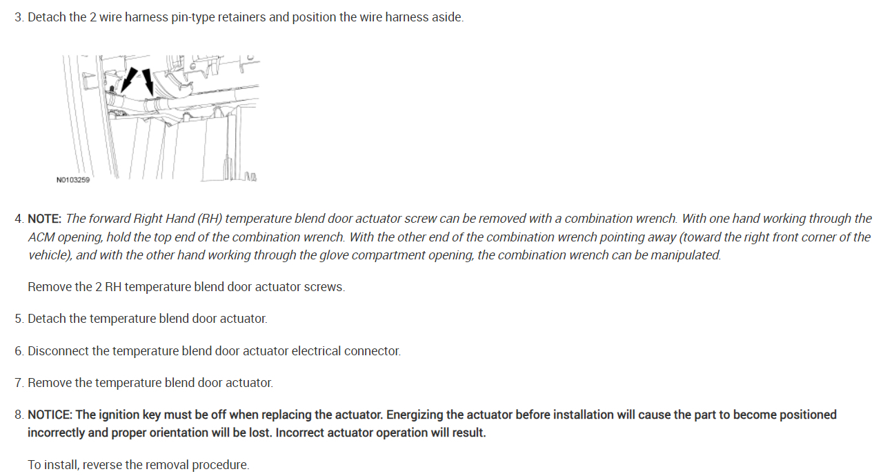

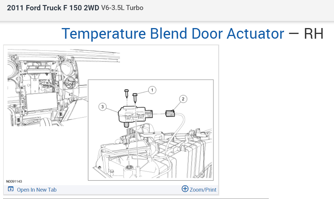

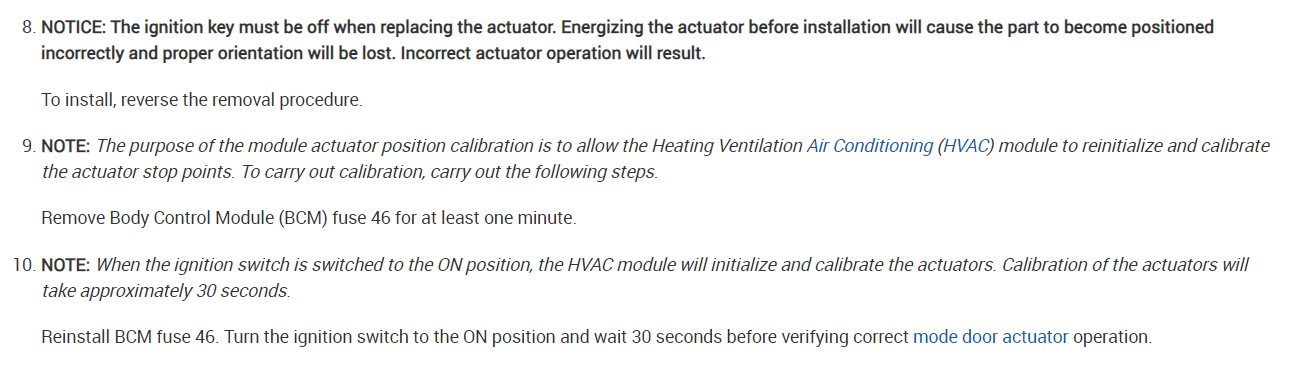

Nice work, thanks for the video. You are correct, the right-side blend door actuator has gone bad. here is the location and how to change it out. Thanks for the video, it helps. Also, I have included how to calibrate the actuator as well. Check out the images (below). Let us know if you need anything else.
