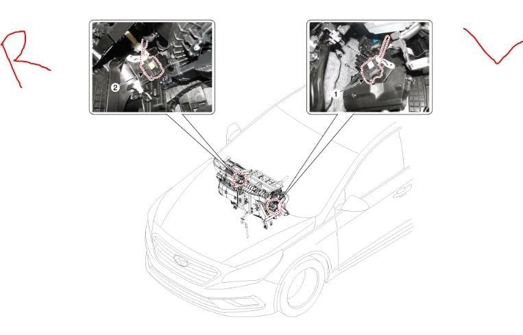

So, when I turn the car on and try to turn the A/C on, none of the buttons work and when it’s on cold it doesn’t blow cold air nor does hot air blow when the heater is on. Also,, when I turn the car off there is a clicking noise that happens and it lasts maybe 30-45 seconds and then stops. What could this be? Help please!

It sounds like the blend air door actuator has failed. When you turn it on, does the fan work? Is the air flow direction working?
Take a look through this link and let me know if anything in it seems to mirror what you are experiencing. The link is a general guide for actuator replacement, but it discusses common symptoms.
Let me know if that is what is happening. Also, let me know if the fan is working as well as the air flow direction.

Yes, that is exactly what is going on!! Where is the blend door actuator located at?

Since this vehicle has dual climate control (left and right side), there are two. Both are under the dash on the HVAC unit. If you look at picture 1, it shows both. I identified left and right.

Here are the directions for replacement. Note if only one side of the system is an issue, only replace that side's actuator. The remaining pics correlate with the directions.

Once you locate the units, actuate them to see if only one or both are making noise. Then you will know which needs replaced.
