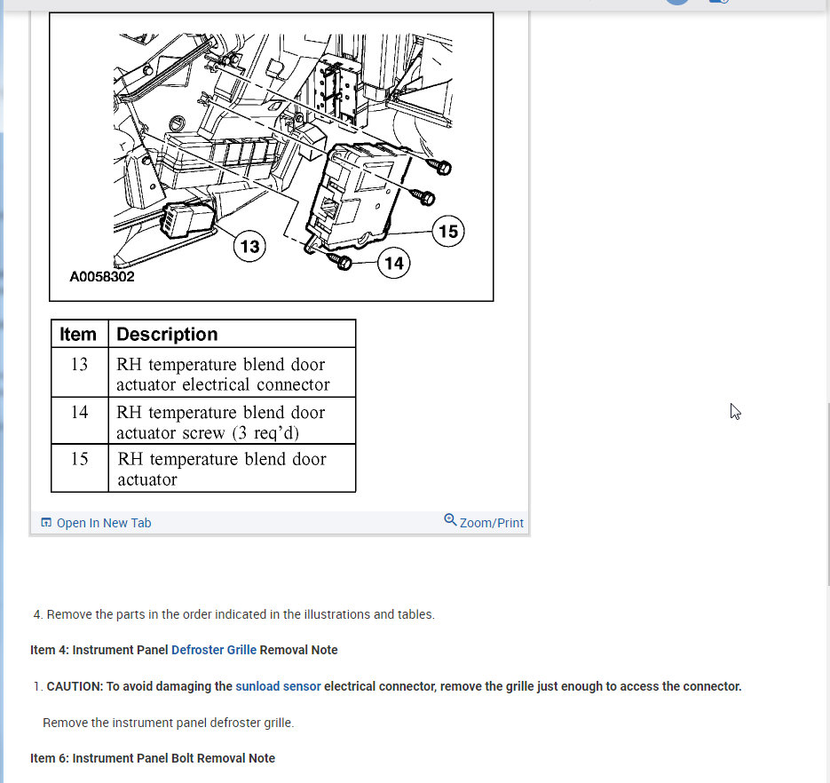

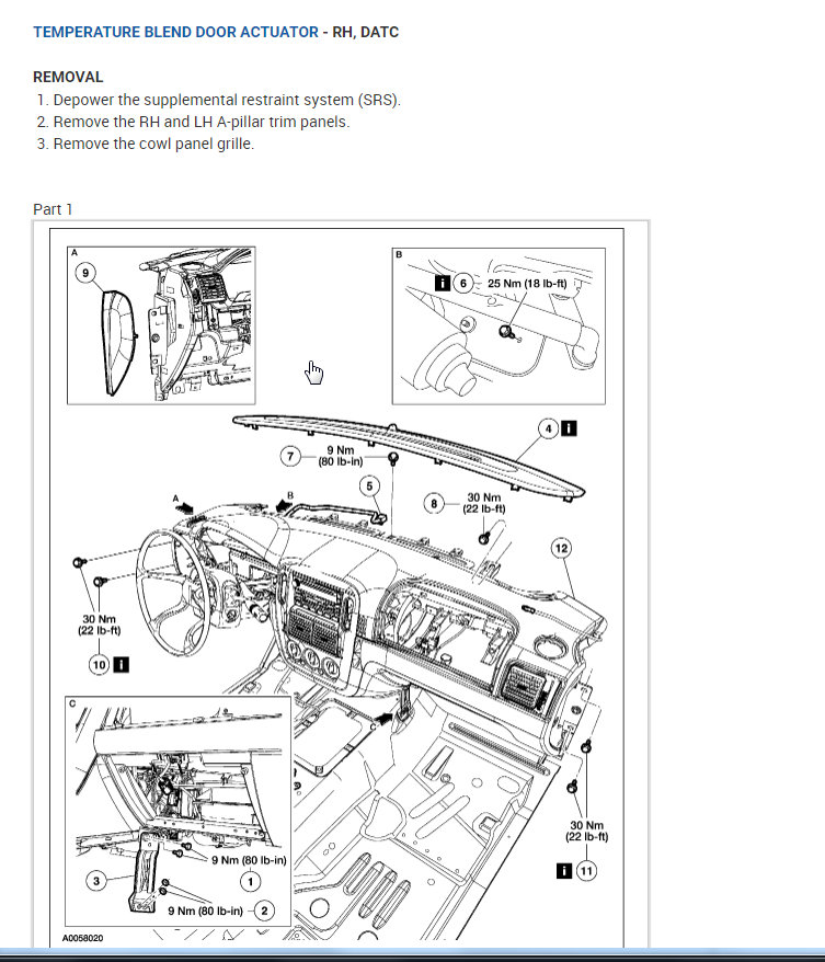

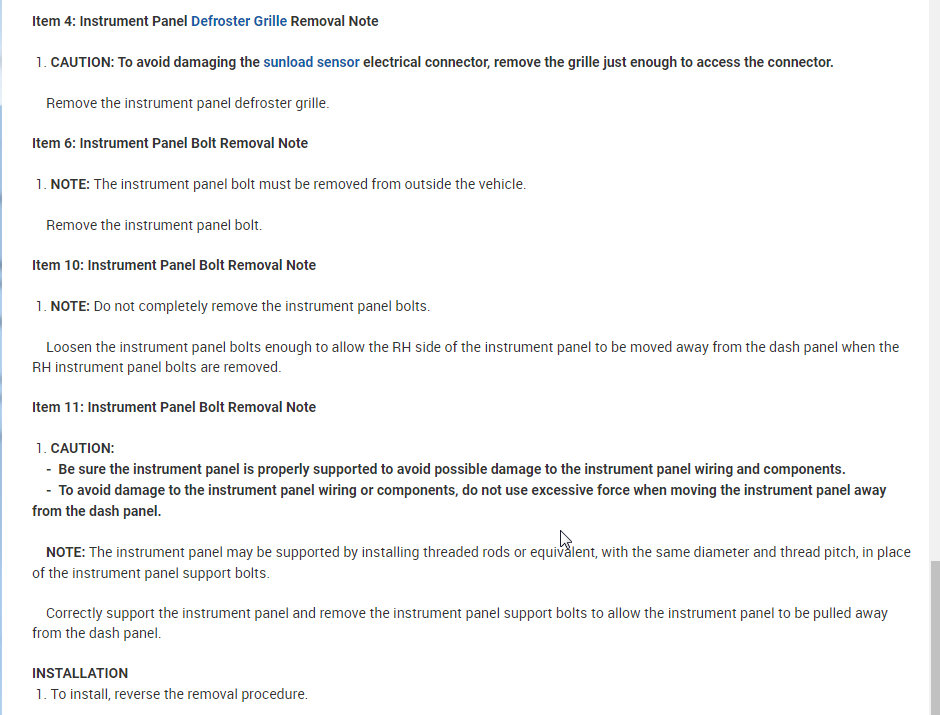

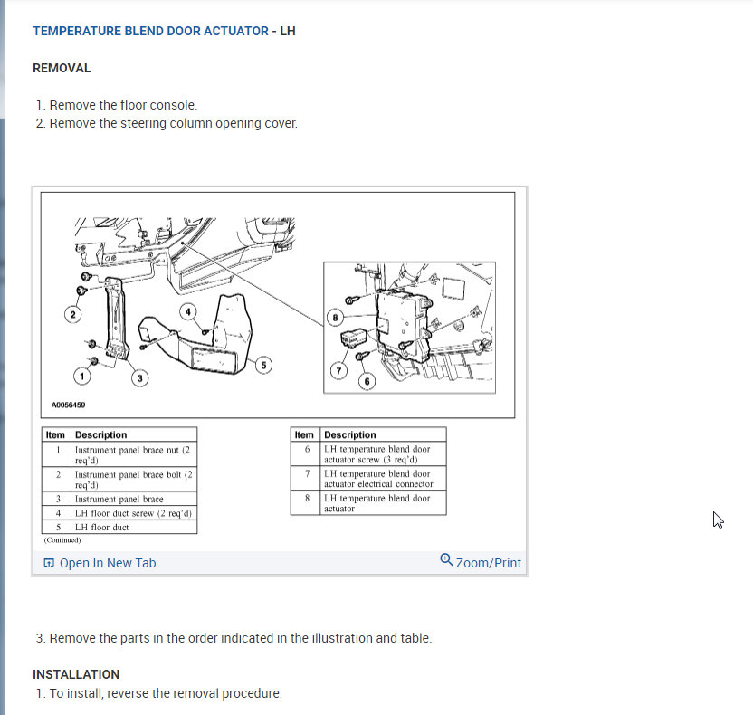

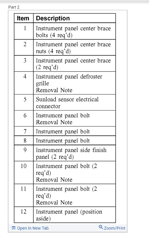

Hello, what is the process in changing out the blend door actuator? I’m getting a clicking noise from the dash when I turn my heat on. No heat and air doesn’t flow from the vents.
Jan 13, 2021 at 10:42 PM
I am attaching the info below on the blend doors on your vehicle assuming you have dual temperature control. If you do not then the left hand door should be the only one you have.
Also, here is a guide that will help with this issue if you need that as well:
https://www.2carpros.com/articles/low-or-no-air-flow-from-vents
