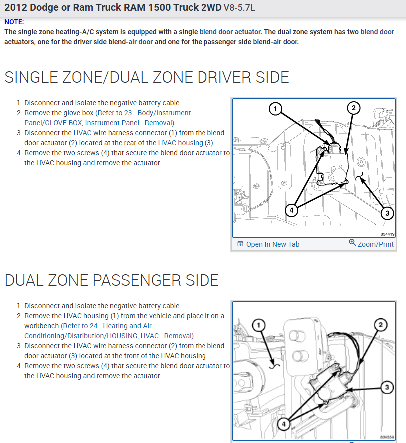

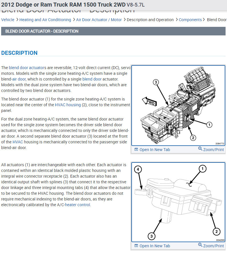

The air blows cold on the passenger side, but blows ambient temperature on the drivers side. Is the problem the blend door actuator and if so where is it located?
Sep 1, 2021 at 5:06 AM
FIREMAN505
Also, I cannot hear any clicking noises or anything else that would indicate a problem.
Sep 1, 2021 at 5:12 AM
SQM
  • 6,383 POSTS

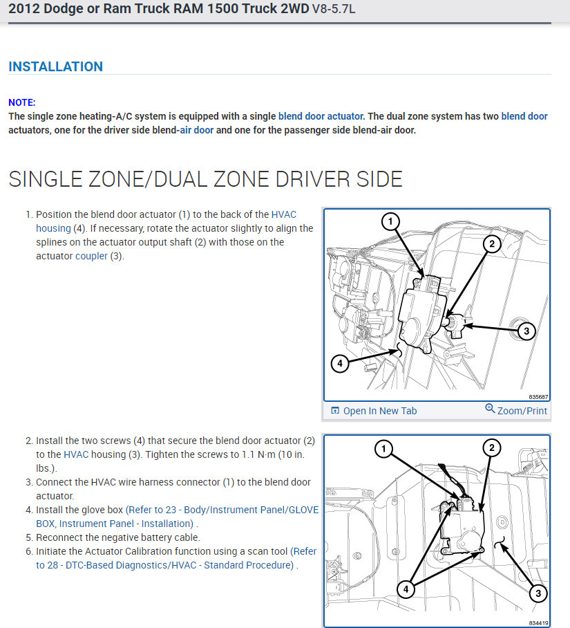

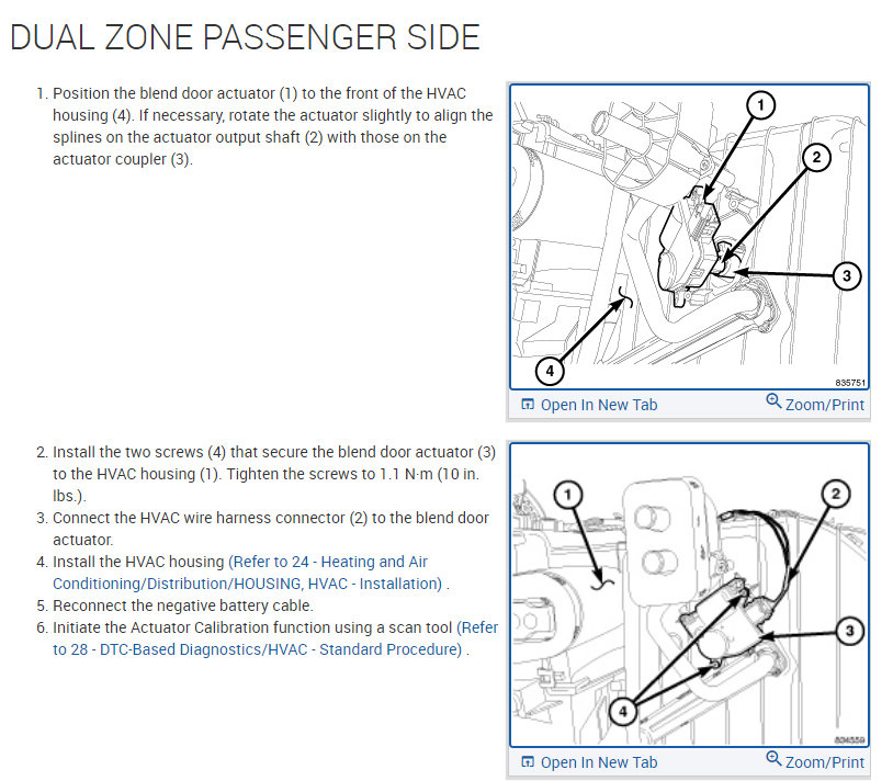

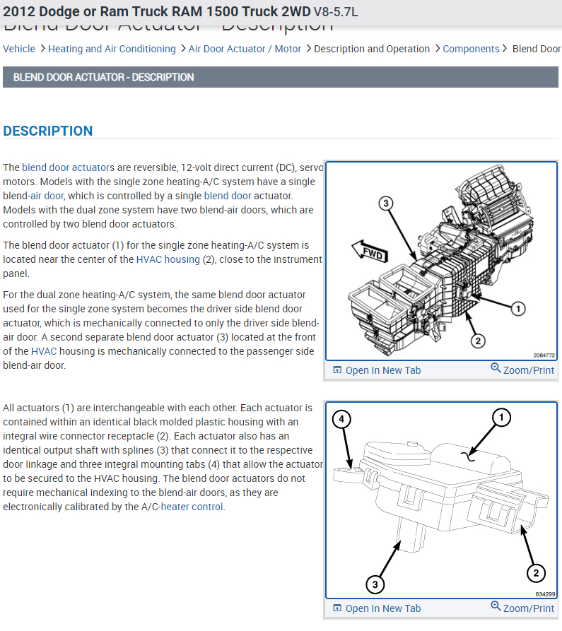

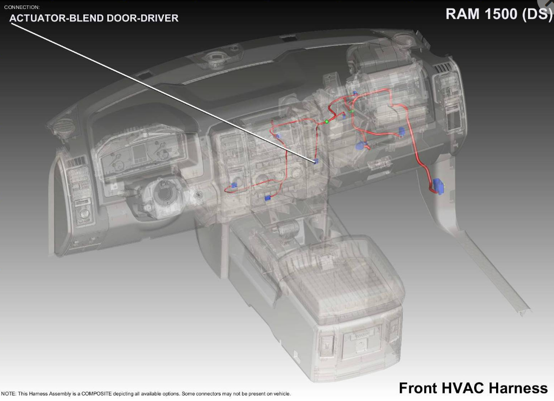

It does sound like a faulty blend door actuator. It is probably just stuck in one position and not turning at all that's why you do not hear the typical clicking sound.
To access the blend door actuator you will have to remove the radio and all the trims below the radio.
Your vehicle has 2 actuators, one for driver and other for passenger side.
See diagrams for the location reference.
Let me know of any questions.

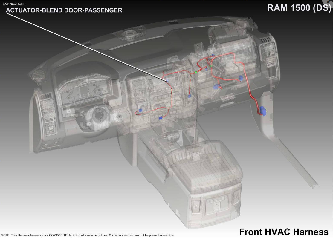

FIREMAN505

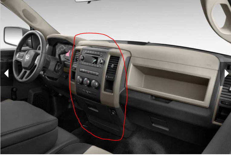

Does the radio need to be removed?
Sep 1, 2021 at 8:30 AM
SQM
  • 6,383 POSTS
Yes, you will have to remove all of the center console/dash area. Look at the picture below.
