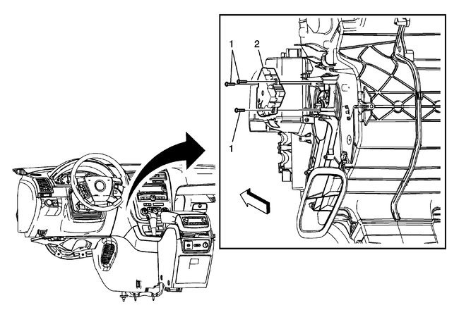

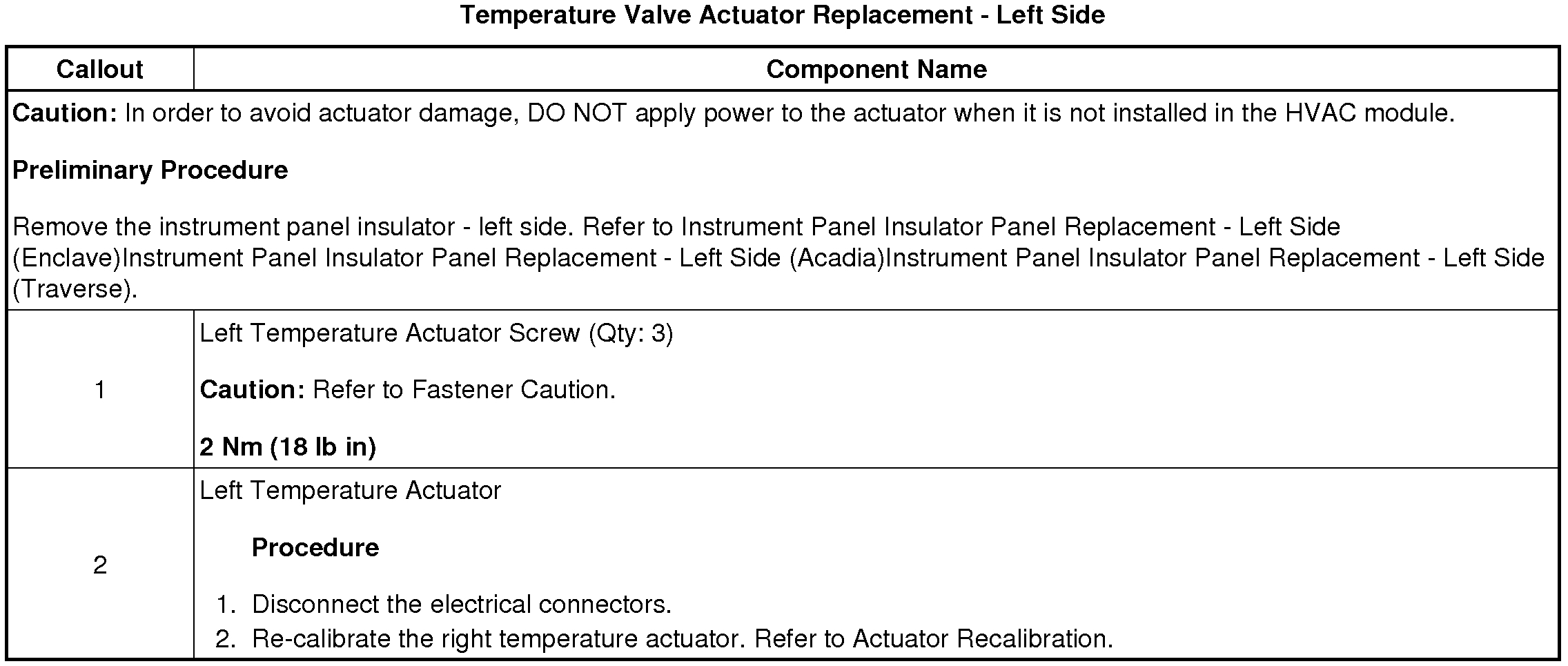

I'm not sure if you already replaced it, but the two pictures below are the directions for replacing the actuator.
Let me know if you have it taken care of.

That I have done on the passenger side and I was able to remove it on the driver side, and place it back. I order a new actuator to replace it.
