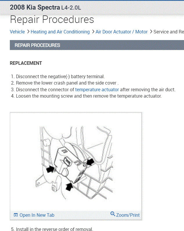

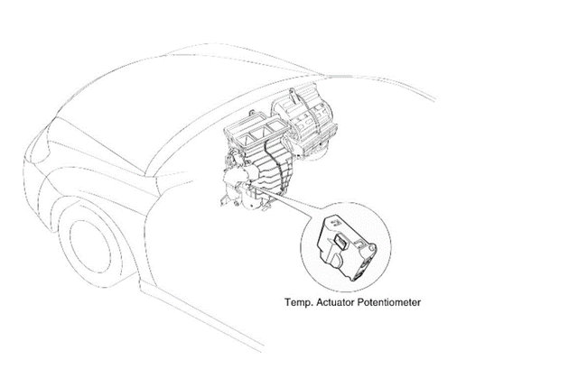

Where is the blend door actuator located?

The blend air door actuator is located under the dash approximately center of the dash. It's mounted on the HVAC box. If you look at pic 1 below, it shows its location.
The actuator is held in with four screws. It's a bit difficult to access, but it can be done.
Pic 2 below provides the very basic directions for replacing it. Here is a link you may find more helpful:
