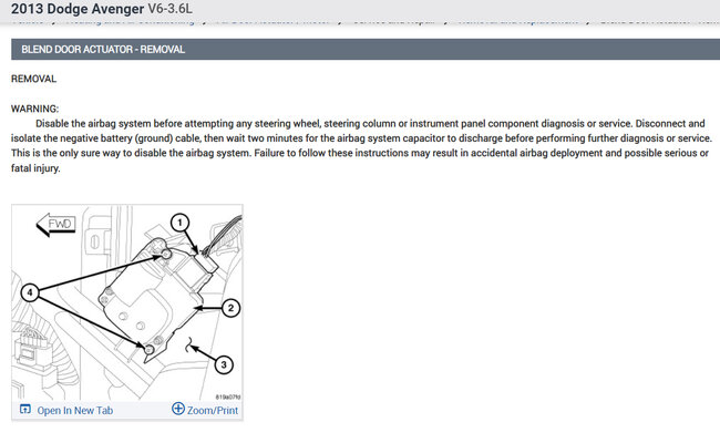

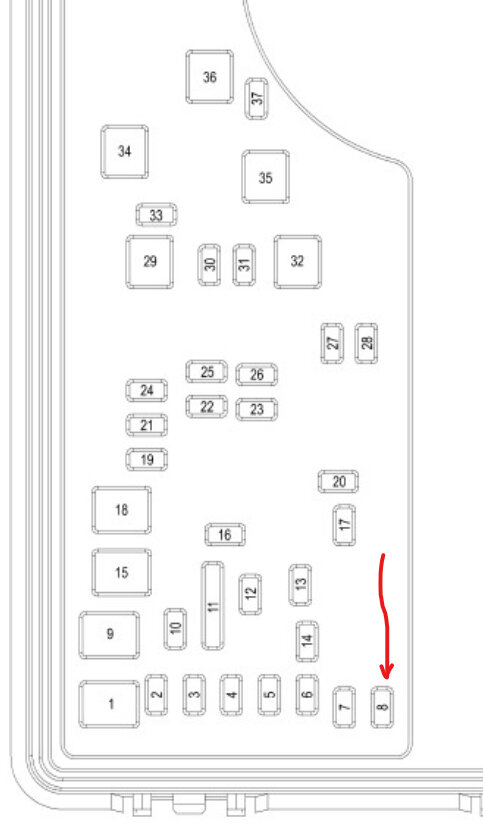

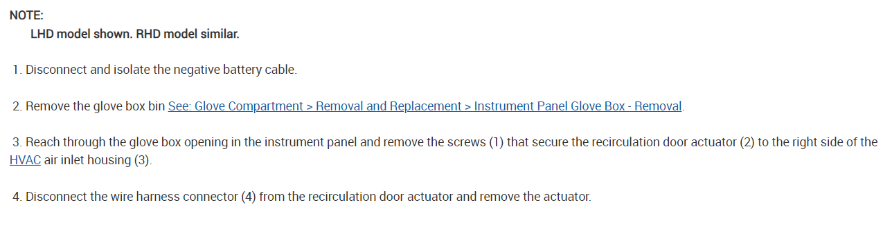

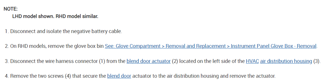

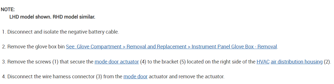

one, or more of my blend door actuators are clicking. Until i can replace them is there a fuse I can pull to just shut the AC/Heating system down?
Jan 13, 2024 at 6:40 PM
  • 54,832 POSTS

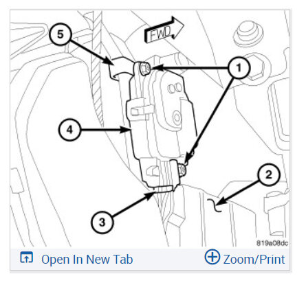

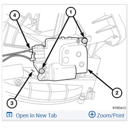

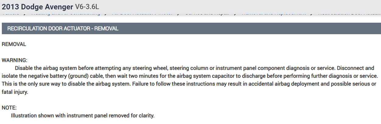

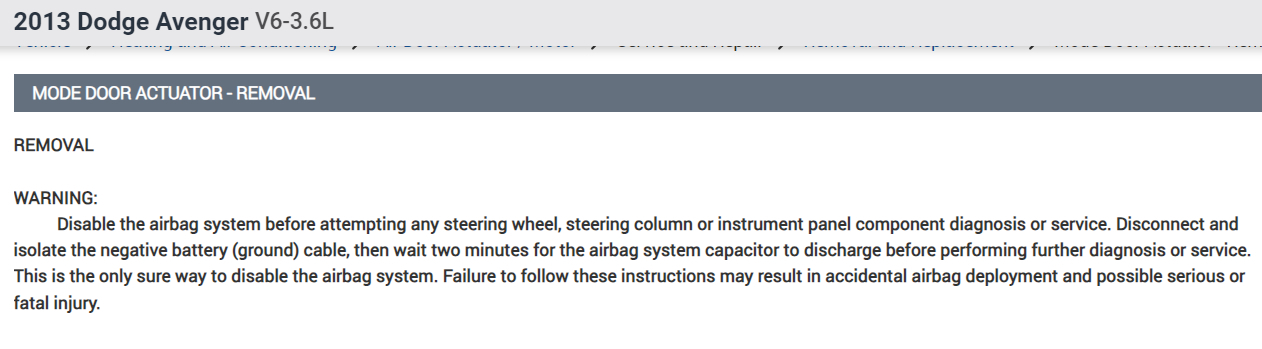

Sure, usually just one of the blend door actuators will go bad and click. Here are the blend door actuators so you can check it out, if you want to disable the system, I would pull fuse #8 in the fuse panel under the hood, here is the location. You will need to remove the glove box to get at the blend door actuators to see which one is ticking. Check out the images (below). Please upload pictures or videos of the problem so we can see what's going on.
