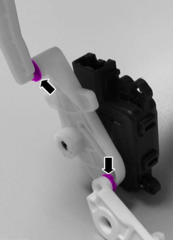

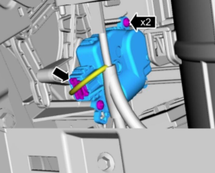

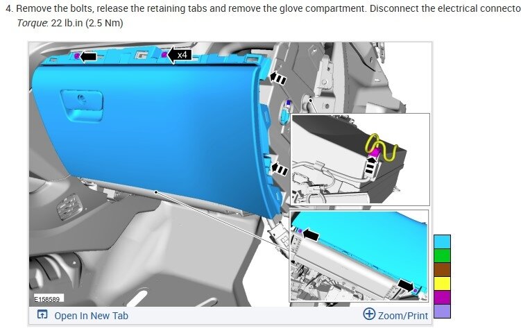

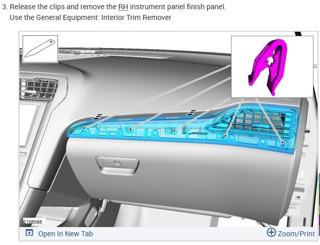

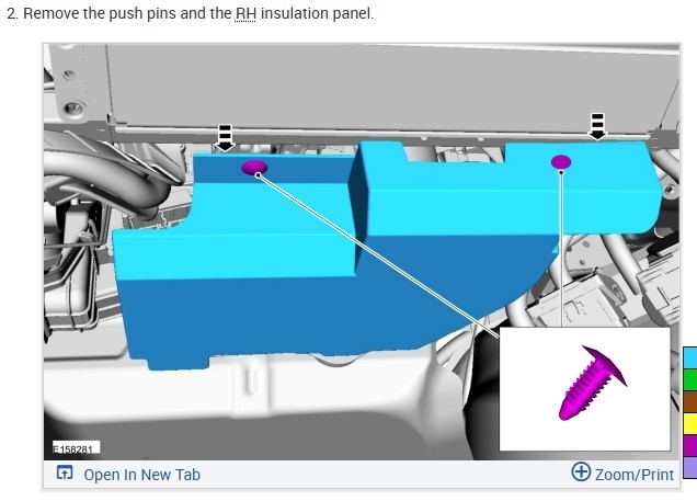

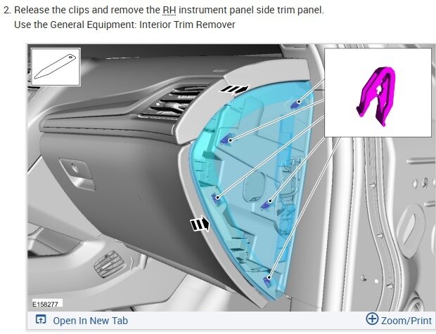

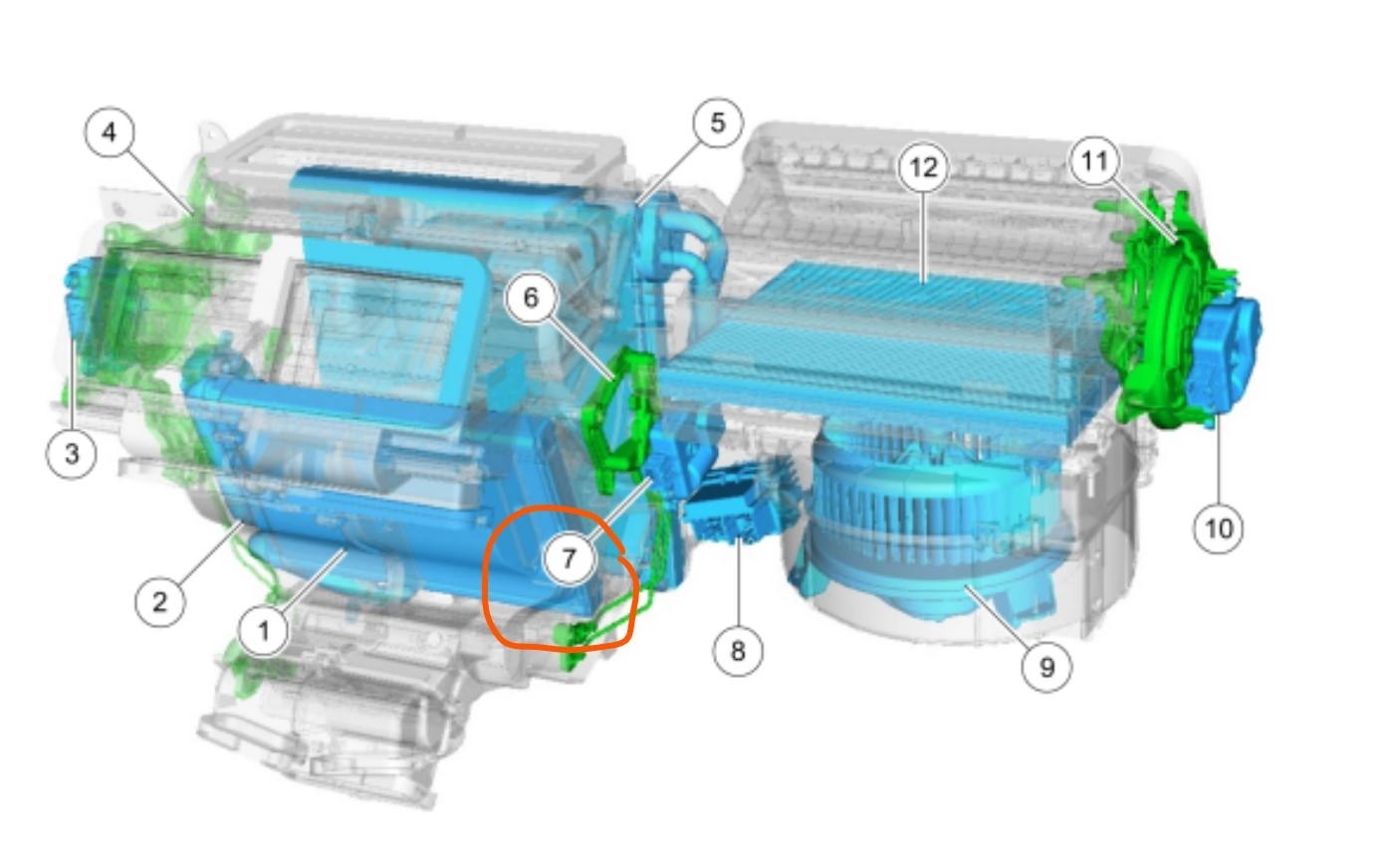

Need help finding the blend door actuator. It’s not a dual climate control system. I’ve heard it’s on the passenger side behind the glove box. And if anyone knows the part number for it at oreillys that’d be great. thanks
Mar 19, 2025 at 5:18 PM
STEVE W.
  • 15,200 POSTS
That is correct. To gain access you remove the lower trim cover under the dash, then remove the glove box. The first 5 images show the process to get to the actuator. The last two show the actuator and the link it moves. The two washers need to be there. Once it is replaced cycle the actuators to be sure they all function.
