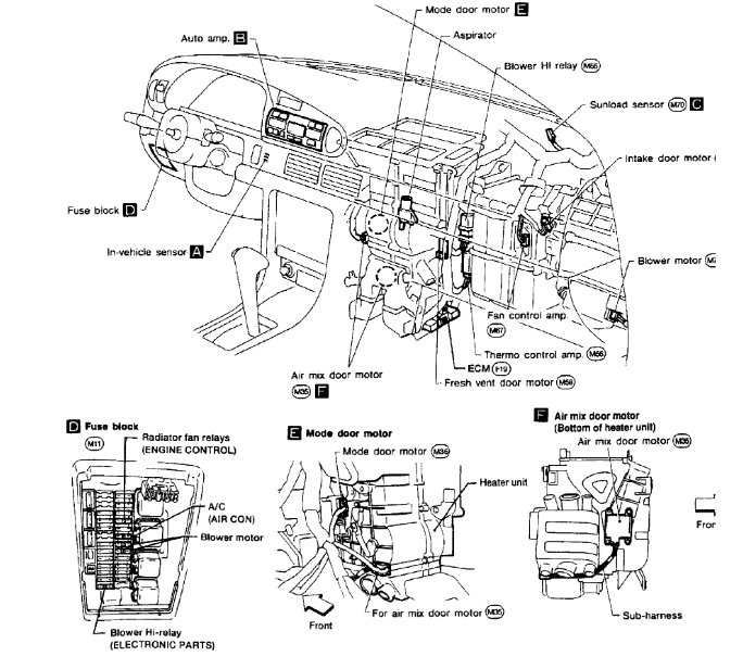

I need to replace my blend door actuator. I don't know which side of the car to go through. Pictures would very much help me. Thanks
Mar 13, 2025 at 3:34 AM
  • 55,713 POSTS

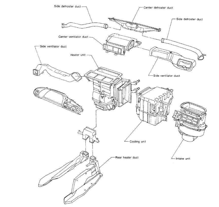

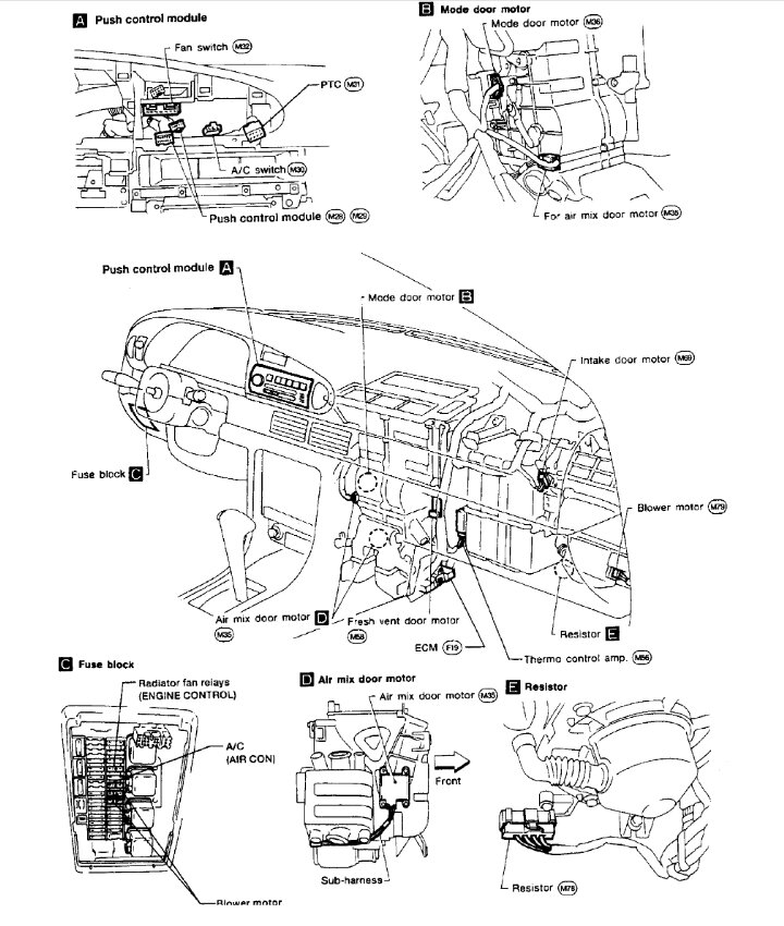

There are two main actuators which one do you mean, the air mix or mode actuators? Here are the locations of the actuators so you can see what I am talking about. Check out the images (below).
Mar 14, 2025 at 1:45 AM
JAMES WAWRZYCKI
  • 6 POSTS
It's the one to switch from hot to cold, and vice versa.
Mar 14, 2025 at 3:17 AM
  • 55,713 POSTS
That would be the air mix actuator which is lower on the HVAC plenum in front. They don't give us step by step instructions so you will need to remove any brackets or dusting to get at the actuator. Please let me know and upload images or a video if you get stuck.

You have pics?
Mar 15, 2025 at 1:30 PM
JAMES WAWRZYCKI
  • 6 POSTS
It looks like the one in the air mix door motor in the pics you sent me. I hope it's the right one.
Mar 15, 2025 at 1:35 PM
JAMES WAWRZYCKI
  • 6 POSTS
I am stuck. I can't get the screws out.
Mar 15, 2025 at 1:36 PM
  • 55,713 POSTS
Yep, that is the hardest part on some of these jobs, you might need a creative way to get to the rear screws. If you upload an image I can try to help. Sorry they don't have any more images or instructions for us on this repair.
Mar 17, 2025 at 2:23 AM
JAMES WAWRZYCKI
  • 6 POSTS
I finished today. I just took the bend door actuator out and moved the bend door by hand. I put a piece of cardboard covered with duct tape to keep it on the cool side. Nice fresh air conditioning. It's great, because I live in Texas. Come winter, I'll move it back to the warm side. Thanks for all the help. I also bought a long 8 mm ratchet wrench to use to get the actuator out. Didn't take long from there.
