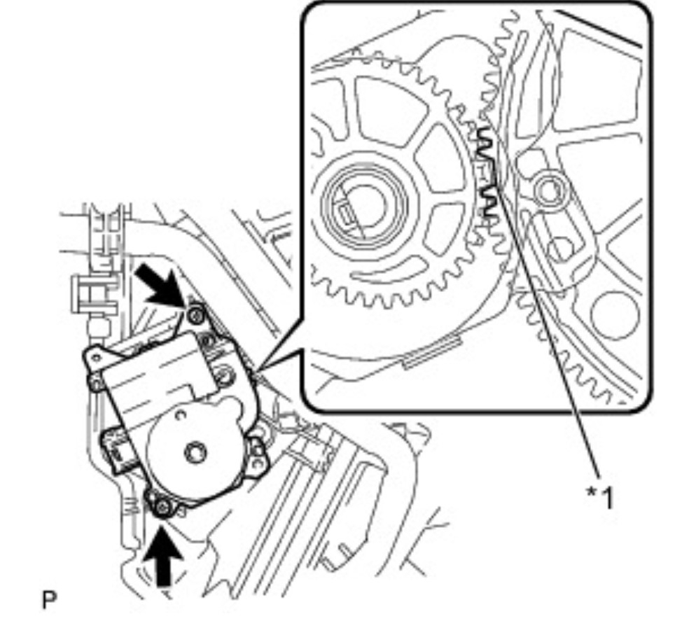

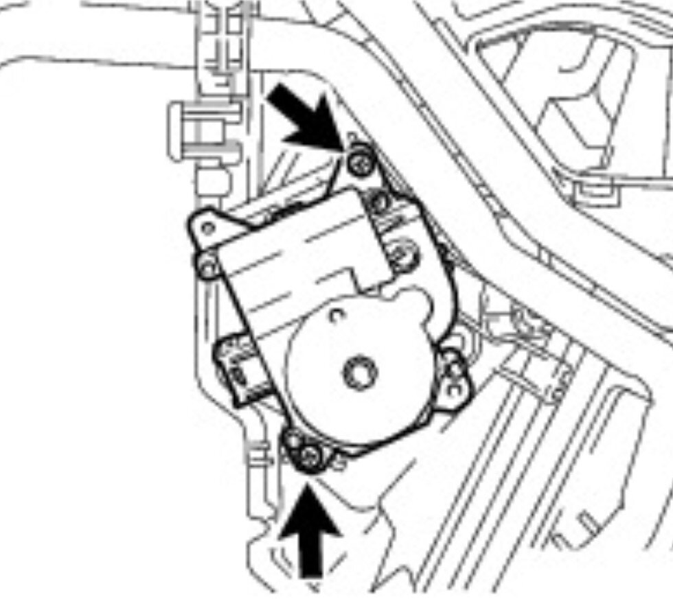

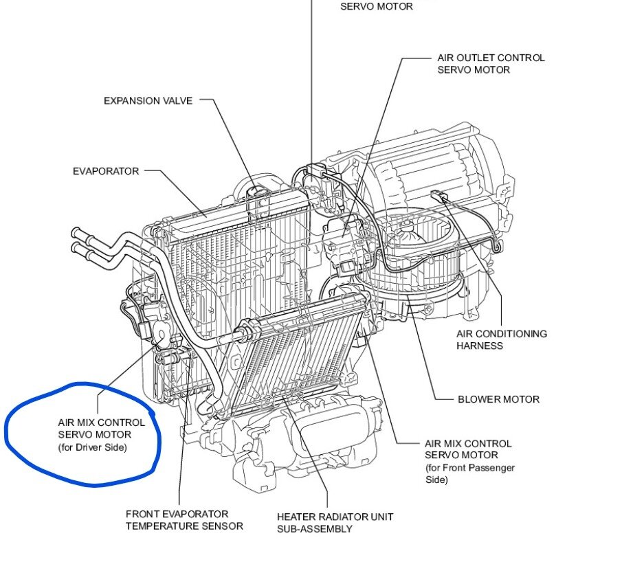

My passenger side I can get to blow hot and cold air. My driver side is only cold air. Where is the location of the door motor I need to replace it?

It should be up above the throttle pedal assembly on the side of the HVAC case, secured with 2 screws. You need to remove the trim panel below the dash and then look up to see it. There are 2 screws to remove, and the actuator comes off. Install the new one with it lined up on the timing marks as shown. Installed properly there is no programming needed.
