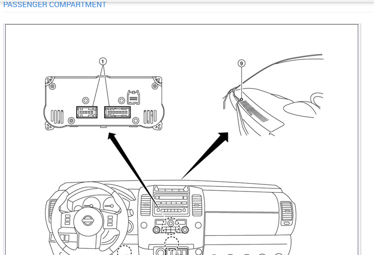

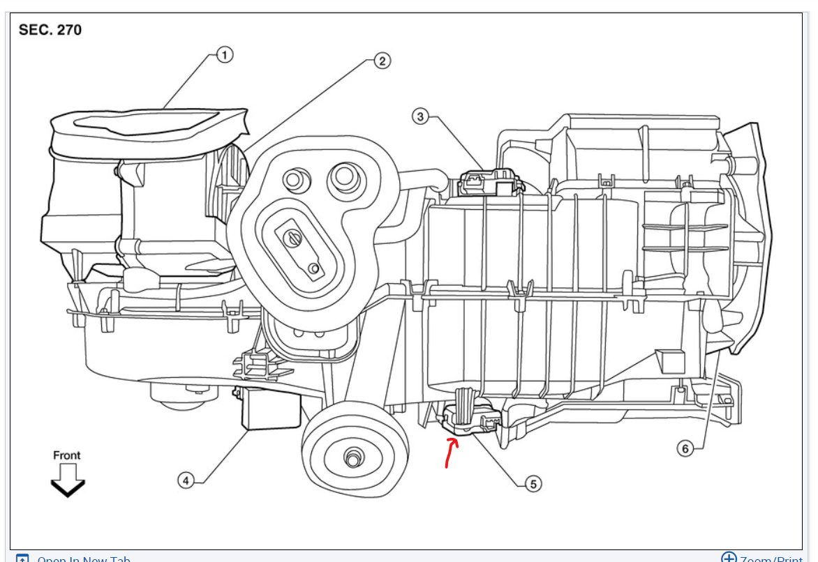

I am trying to confirm the location of the blend door actuator that controls the passenger side temperature. My passenger side temperature is stuck on cold but my driver side temperature changes from hot to cold.

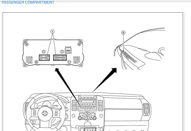

Sure, it is the air mix blend door actuator at the bottom center of the HVAC plenum, check out the images (below). Let us know if you need anything else.

If you click on the images I uploaded in the first post it shows the location of the actuator, can you double check it for me?
Oct 30, 2024 at 2:38 AM
MATT HAWES
  • 9 POSTS
The actuator I replaced appears to be the same one as in the picture. It is behind the glovebox under the dash all the way to the left.
Oct 30, 2024 at 6:55 AM
  • 55,746 POSTS
Yep, it is in the middle of the HVAC plenum. so, with the actuator unbolted but wires connected, works the HVAC temperature controls from cold to hot to see if the actuator swings each way.

I tried the 3rd option of clearing the memory and de-energizing everything with no luck. I hooked back up the actuator that is located under the left side of the glove box. When turning the truck on and letting it heat up the actuator under the glove box does in fact control the driver's side and not the passenger's side. I do believe the passenger-side actuator is located on top of the air box behind the dash where it cannot be accessed.

Yep, that is not the first time the manual has been incorrect. I like to move the blend door pivot when the actuator is not connected to see what changes to confirm the correct actuator is being replaced. Good find. Please start a new question for each additional issue.

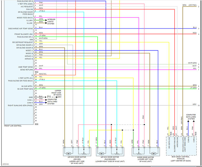

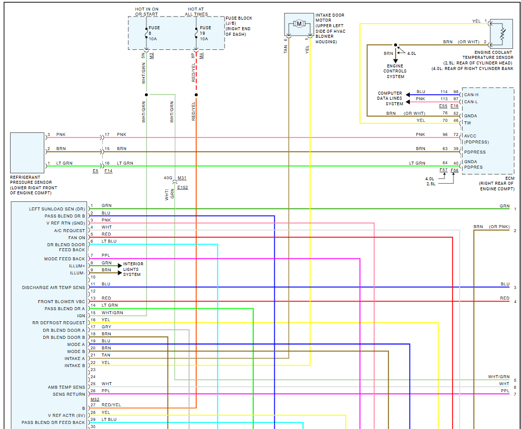

Yes, when the actuator was removed and I turned the pivot stem it only affected the driverside temperature. The other day I hooked my truck up to a code reader. No codes were present but when I went into the HVAC section I could see both the driver mix feedback and passenger mix feedback. When adjusting the temperature on the driver side, the voltage changed from about .65 up to around 4.53. When adjusting the passenger temperature it didn't change and was stuck on .71. Could this be a ground issue? Seems like the passenger-side actuator is getting power but something is keeping if from working correctly. Any thoughts?
Nov 24, 2024 at 11:28 AM
  • 55,746 POSTS

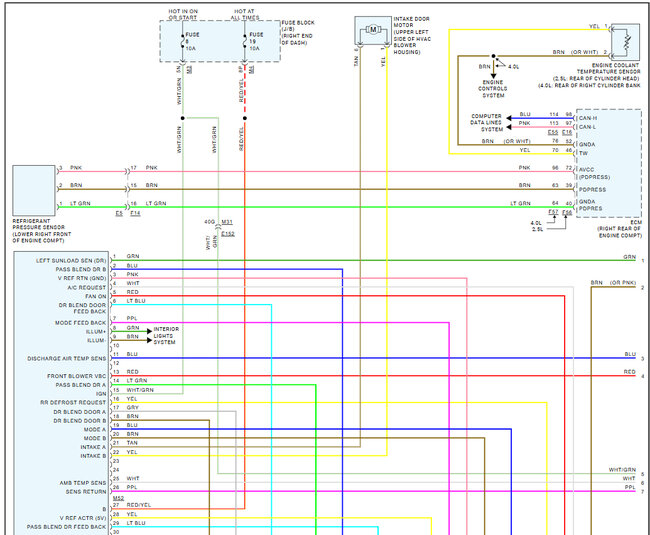

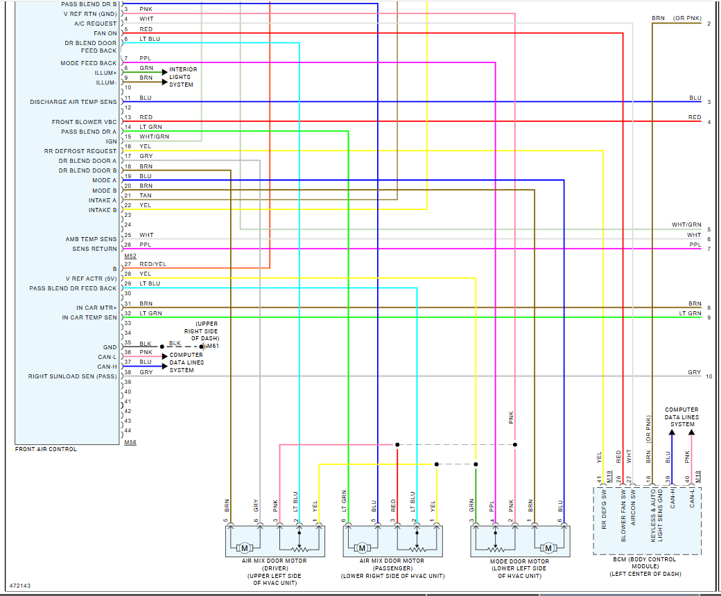

This can be a defective actuator not communicating. It does not look like there is any initializing for the actuator. So, I would try an OEM replacement and if that doesn't work here are the wiring diagrams so you can check the connections and if okay replace the HVAC control unit.

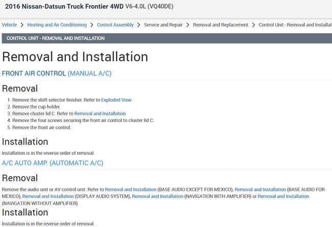

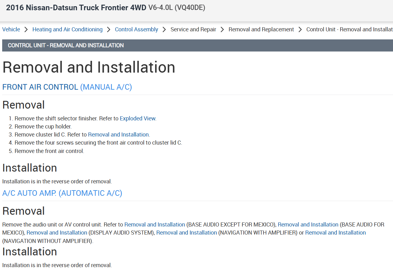

Here is how to change out the HVAC control module in case you need it. Check out the images (below). Please let us know what happens.
