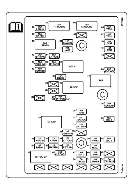

Replaced the battery, vehicle was without a battery for three days. Installed new battery. Started car and one of the blend doors clicks for about sixty seconds and then quits. Cannot get the controls to redirect the air flow out of the dash vents. It happens everytime I start the car. Did not have the problem before the battery replacement.

Hi again.
Since this is the automatic system, there is a chance the HVAC actuators need to re-calibrate. What I need you to try is this. Remove fuse 36 from the fuse block under hood. It should indicate its location on the backside of the cover. Allow it to be removed for at least two minutes. Next, reinstall the fuse and allow the system to re-calibrate. Do not make any Adjustments when the system is doing this. Allow at least another two minutes for it to complete the reset. After two minutes, start the vehicle and see if it worked.
I attached a picture of the fuse block for your review.
Let me know if this helps.

After doing a lot of research online before asking you guys I did try this multiple times because it does seem to be the solution for most people. It does not fix it. I have also tried unplugging the battery for a bit. Any other suggestions?

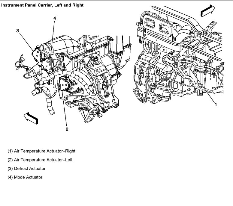

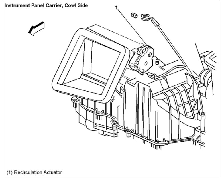

It still sounds like the blend door actuator is out even though it moves. Please find the unit that is making the noise and change out the actuator. Here is a guide to help you see what you are in for and the location of the actuators:
Check out the diagrams (below). Please let us know what you find.
