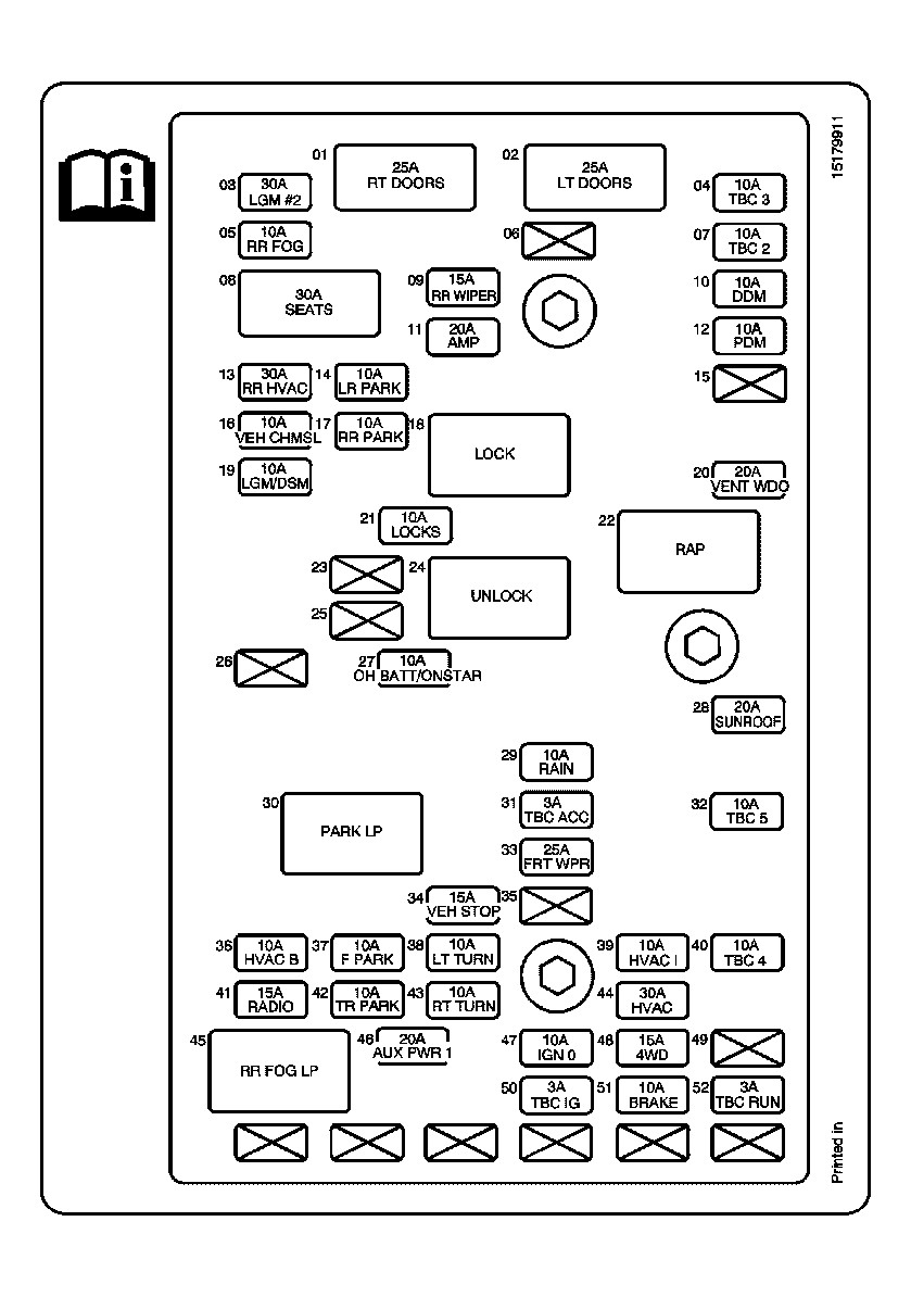

Since this is the automatic system, there is a chance the HVAC actuators need to re-calibrate. What I need you to try is this. Remove fuse 36 from the fuse block under hood. It should indicate its location on the backside of the cover. Allow it to be removed for at least two minutes. Next, reinstall the fuse and allow the system to re-calibrate. Do not make any Adjustments when the system is doing this. Allow at least another two minutes for it to complete the reset. After two minutes, start the vehicle and see if it worked.
I attached a picture of the fuse block for your review.
Let me know if this helps.

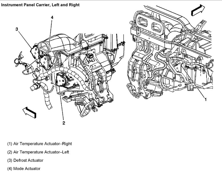

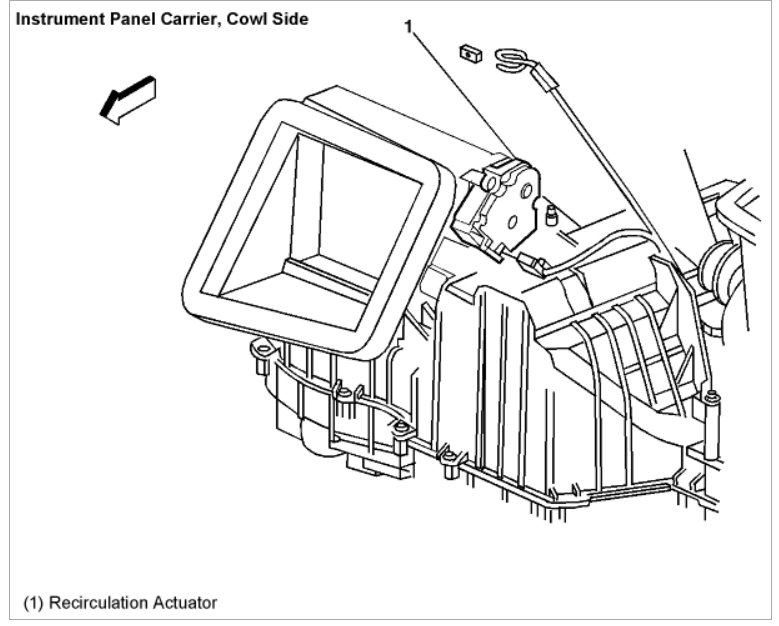

It still sounds like the blend door actuator is out even though it moves. Please find the unit that is making the noise and change out the actuator. Here is a guide to help you see what you are in for and the location of the actuators:
Check out the diagrams (below). Please let us know what you find.
