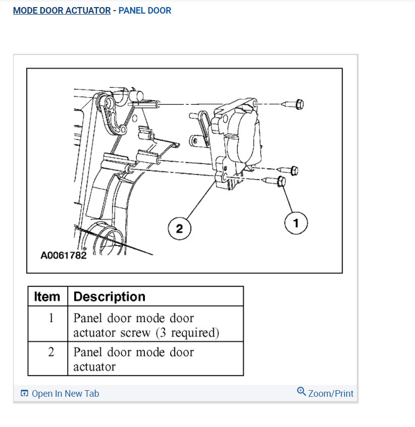

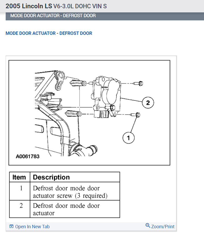

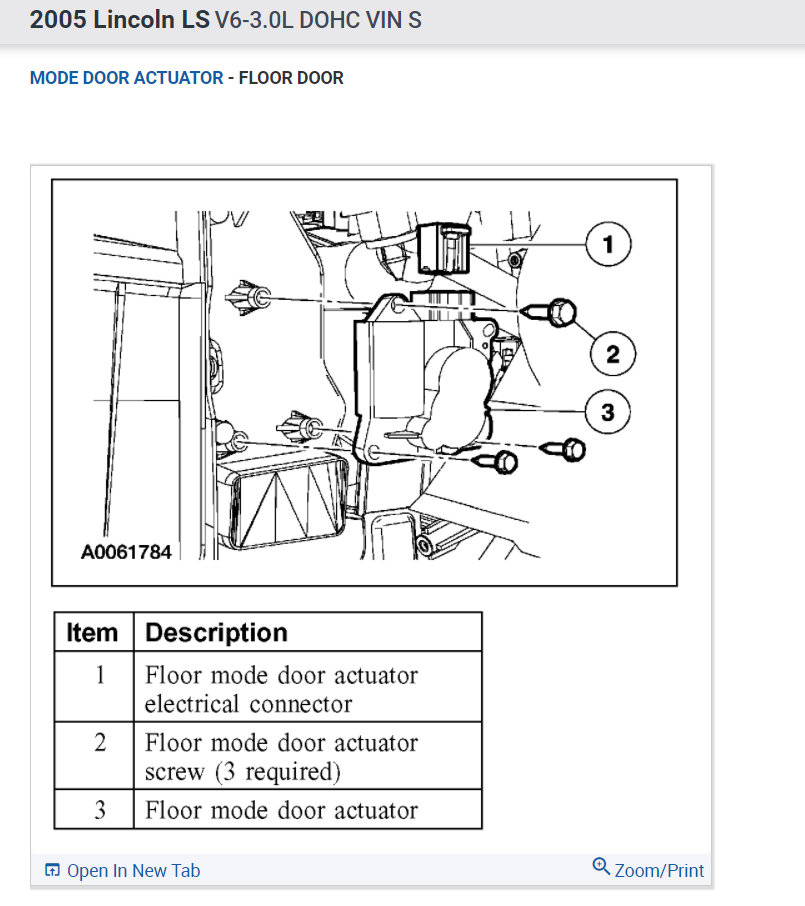

The car only blows hot air. Even when I turn the temperature down to 60 it still blows really hot. How do I go about fixing or replacing the blend door?
Jun 18, 2021 at 11:59 PM
  • 54,832 POSTS
Here is a guide to help you step by step with instructions in the diagrams below to show you how on your car. It should be the mode actuator but they name it differently so I would try removing the easiest one and move the pivot to see what it controls. Here is a guide to help you step by step with instructions in the diagrams below to show you how on your car:
