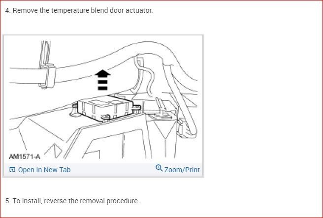

How to increase the air conditioning air flow with out removing the blend air valve?
If I need to replace the valve how to do it? In details.

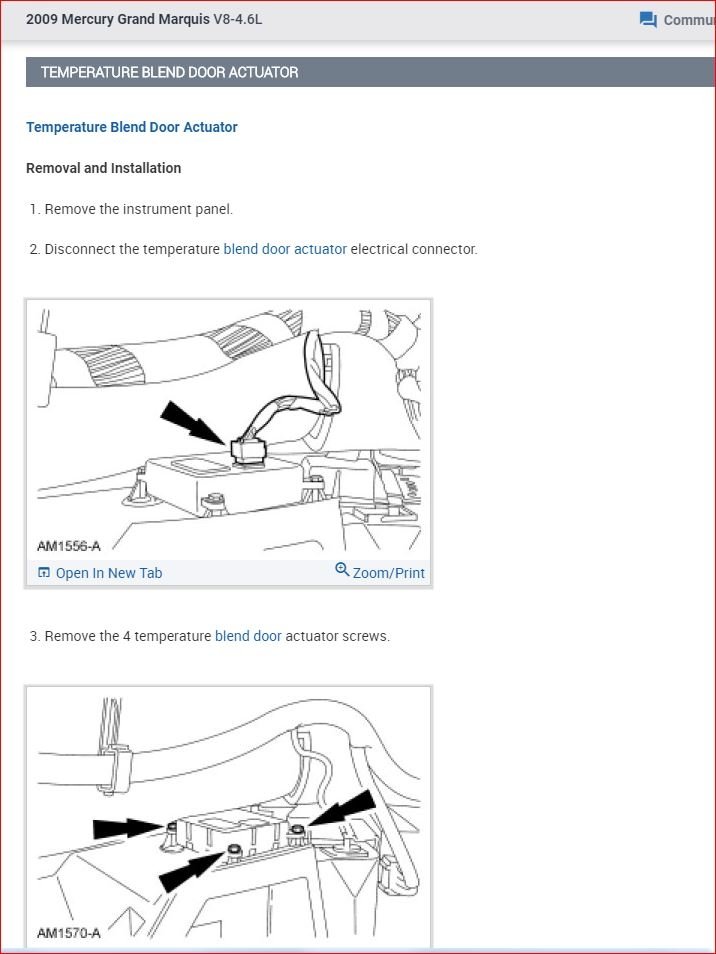

Hi Balzabin,
I attached the process for replacing the blend door actuator. If you hear a ticking noise, then most likely it is one of the actuators. The easiest way to know which door it is, is move the temperature up and down and then move the mode switch one at a time and see which one makes the noise.
If the temp makes it click, then that is the blend door. If it is the mode position then that is the mode doors actuator.
However, the reduced air flow is not necessarily the blend air door because this doesn't effect the amount of air. It just effects the temperature of the air. The amount of air is determined by the blower motor.
