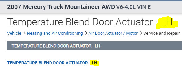

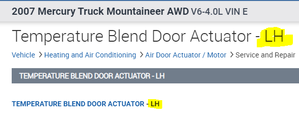

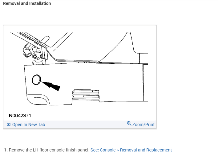

blend air door intermittently sticks on full heat mode?
2007 MERCURY MOUNTAINEER
92,000 MILES • 4WD • AUTOMATIC
GALEN MAX CLARK
If I change temperature from hot to cold back and forth several times I can get to cool. It used to make a squeaky scraping noise when I put the key to on but makes no noise when it gets stuck. I can't seem to find the location of the motor on this vehicle. Thanks, Max
Oct 20, 2022 at 6:52 AM
  • 110,244 POSTS

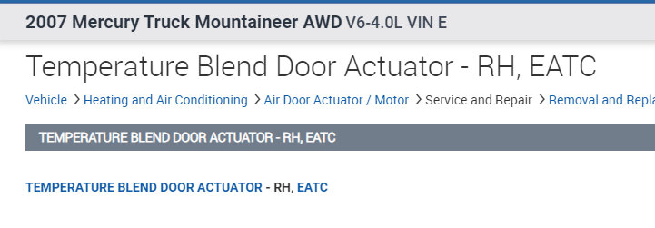

On this vehicle, there will be two, one for the driver and one for the passenger side. If you look at pic 1 below, it shows their locations.

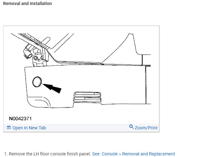

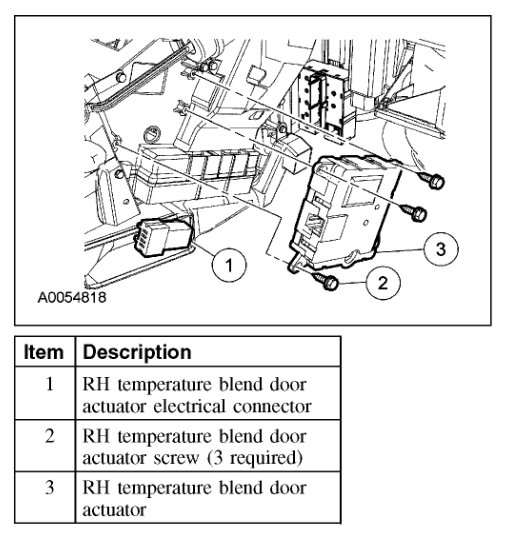

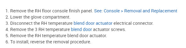

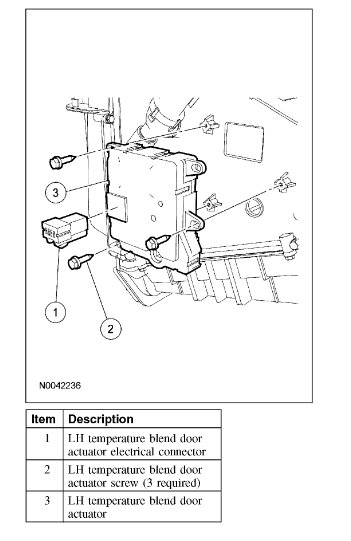

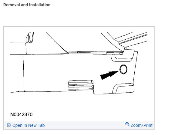

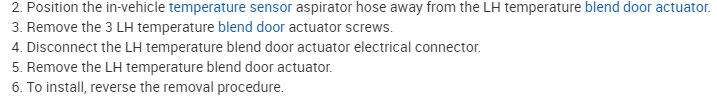

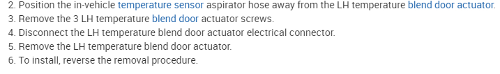

The remaining pics are the directions for replacing both of them. Additionally, here is a link that explains in general how it is done. Once the actuators are located, I find it easier to follow. LOL
Take a look at the pics below and let me know if they help or if you have other questions.

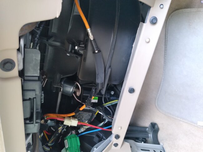

GALEN MAX CLARK
My Mountaineer looks like this. Thanks
Oct 27, 2022 at 4:41 AM
  • 110,244 POSTS

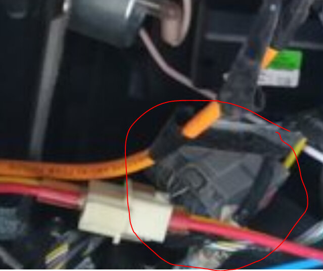

That looks correct. I copied your pic and circled what I believe to be the actuator.
See pic.
