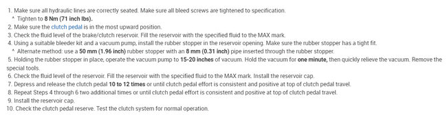

I just finished installing a new clutch. I bench bled the throw out bearing before i installed it. Now i have seen many people install a stopper on top of the brake fluid reservoir. I did that, my question is when i install the stopper on top with a hose in the middle and a vacuum pump, i pump the pedal several times the i release the air. Does the hose need to be immersed in the fluid when i pump the vacuum pump, or just on top of the fluid level?
Dec 13, 2021 at 10:49 AM
  • 110,251 POSTS
The hose does need to be immersed in the fluid. Otherwise, it will pull air back through when you release the vacuum.

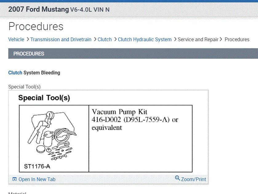

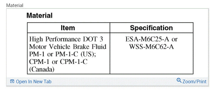

If you look at the attachments below, they provide the procedure for bleeding specific to his vehicle. Take a look through them and let me know if they help.
