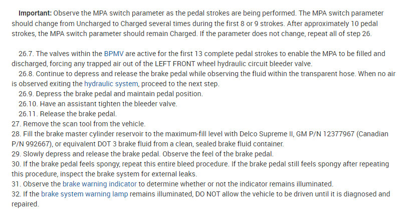

Have replaced master cylinder and all brake lines and brakes will not bleed. What else could I check or do?
Jul 4, 2016 at 3:04 AM
SQM
  • 6,383 POSTS

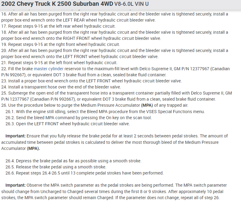

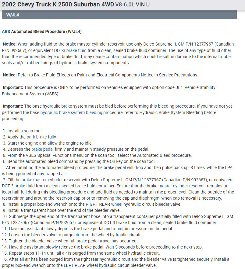

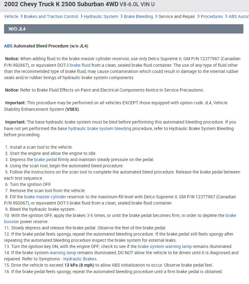

Sometimes the brakes will not bleed if the correct procedures do not get followed.
Here is a helpful video of how to bleed ABS brake system:
https://youtu.be/nQRnKyVyMuQ
https://www.2carpros.com/articles/how-to-bleed-or-flush-a-car-brake-system
I have attached the brake bleeding procedure for both active and standard brake system below.
