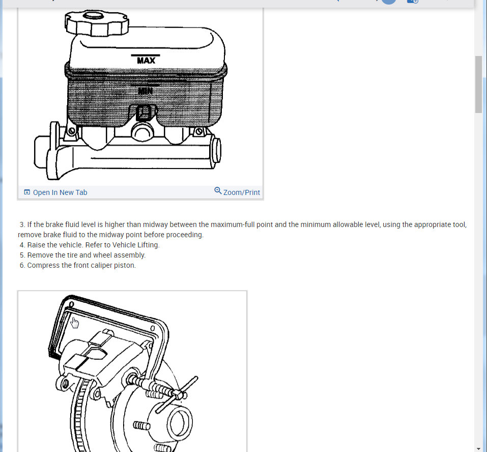

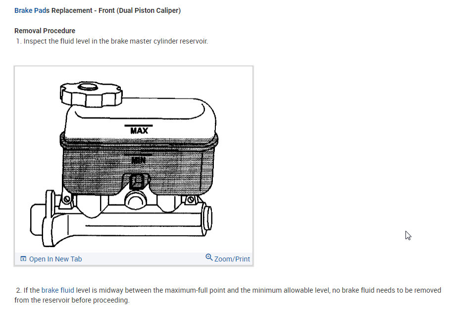

I need to do the front brakes and bleed the abs system
Feb 16, 2019 at 4:57 PM
Here is a guide that will help with this:
https://www.youtube.com/watch?v=1dB17cMwSOQ
https://www.youtube.com/watch?v=OYmzl1LSfX0
Below you will find the info from the manual that will help with this as well.
Let us know if you have questions. Thanks
