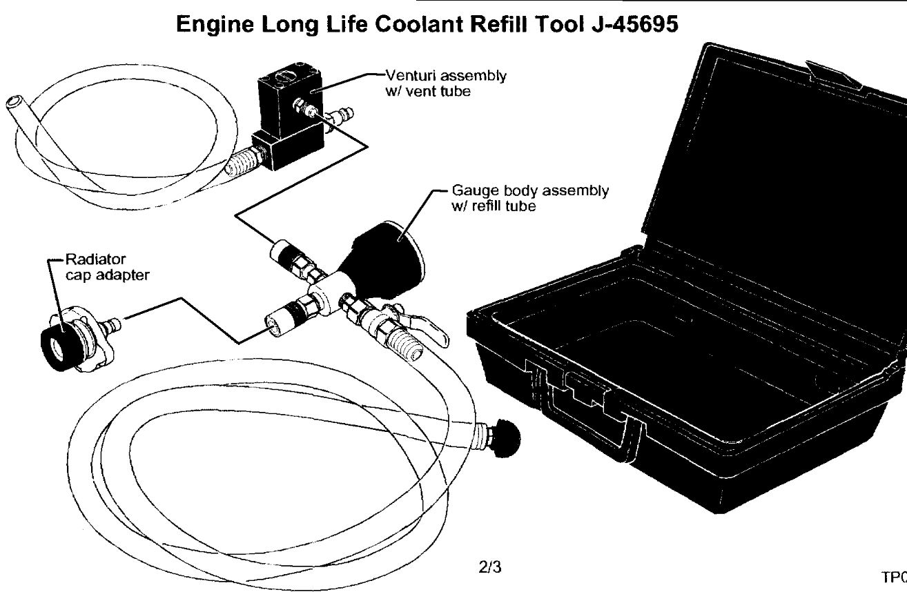

I installed a new radiator in my car, how do i bleed the system of air?

On that design which doesn't have a bleed port or screw there is only one reliable way to fill it without trapping air in the system and that is to use a vacuum fill system. That goes onto the reservoir and pulls all of the air out of the empty cooling system, then you insert the fill hose into a container of the new coolant and open the valve. The vacuum inside the system then draws in the new coolant.
You can usually get that tool as a loaner from some parts stores, but you need an air compressor to use it as it uses the air to create the vacuum.
