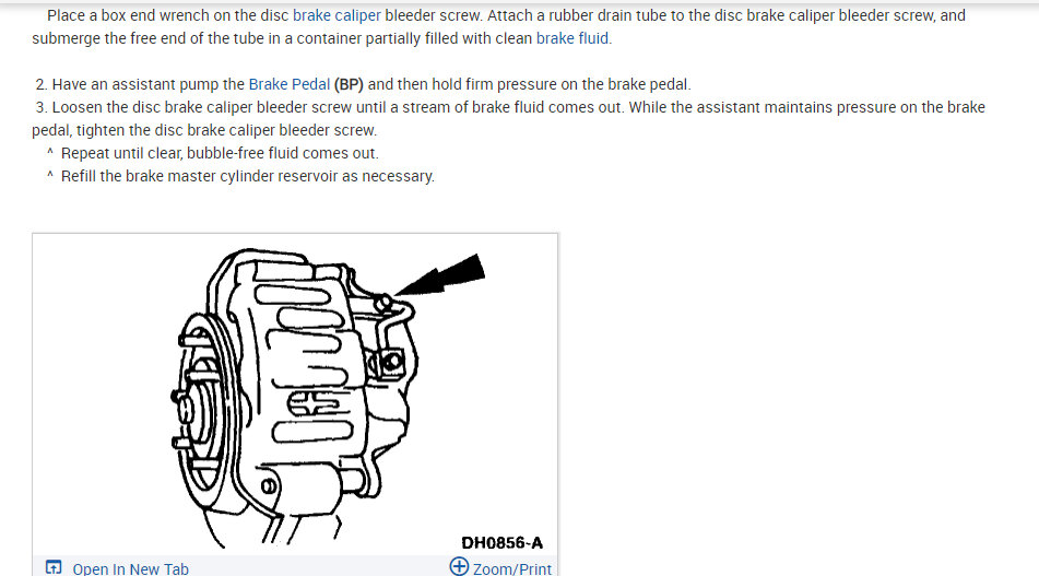

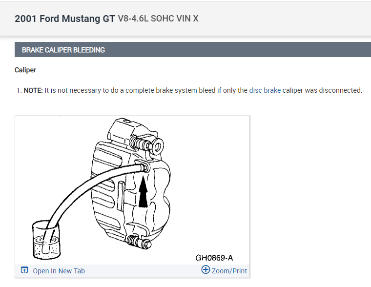

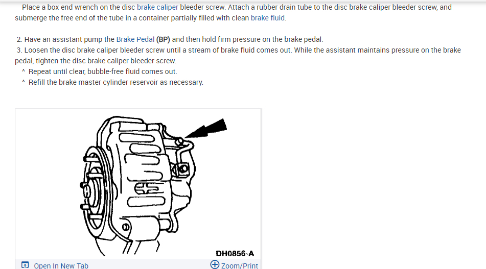

have to replace front calipers, need to know if i have to bleed all 4 wheels or just the front. Thank you.
Feb 5, 2024 at 7:56 AM
  • 110,251 POSTS
As long as the brake master cylinder reservoir never fully drained to a point air could have entered the system, you should be able to just bleed the fronts.
I attached the directions from the manual for bleeding the new calipers. Let me know if this helps. Also, if you are experiencing problems, let me know what they are.
